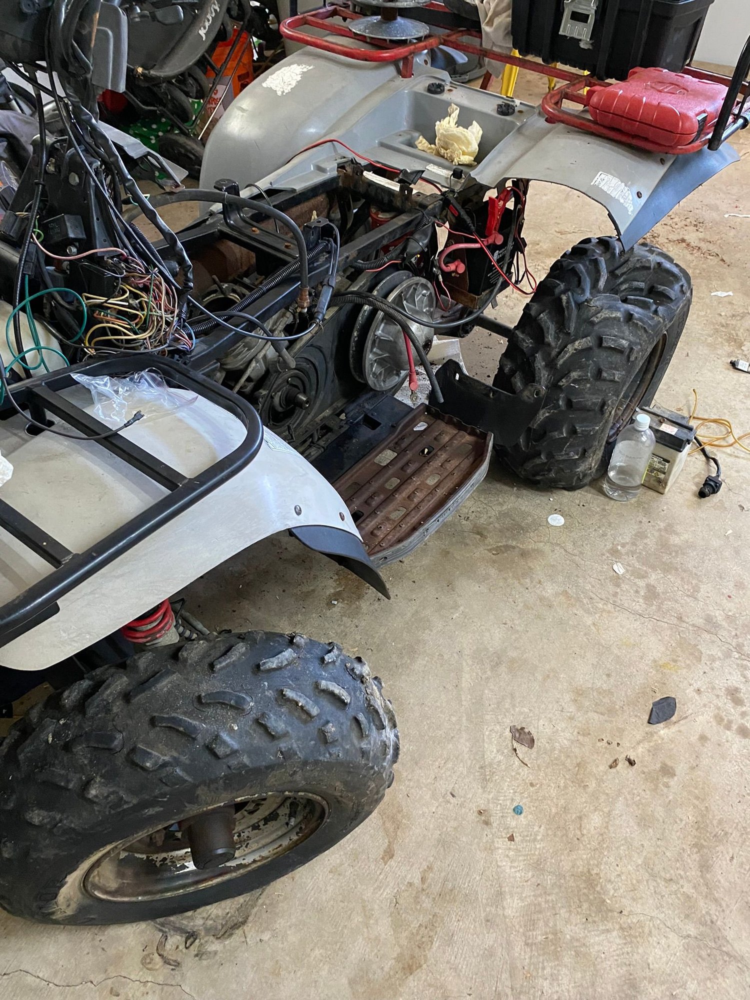

Hello all, I recently bought a seized Trail Boss 350L, with the scarcity and insane prices of these old parts I want to explore alternatives.
The quad is missing the fueltank, air box assembly, all center plastics.
  • Fuel tank, are there generic options? Anything sub $150 for a used part?
  • Intake air box - aftermarket options?
  • Downtube/coolant res - can I just buy a new coolant res and run tubing for the clutch vent?

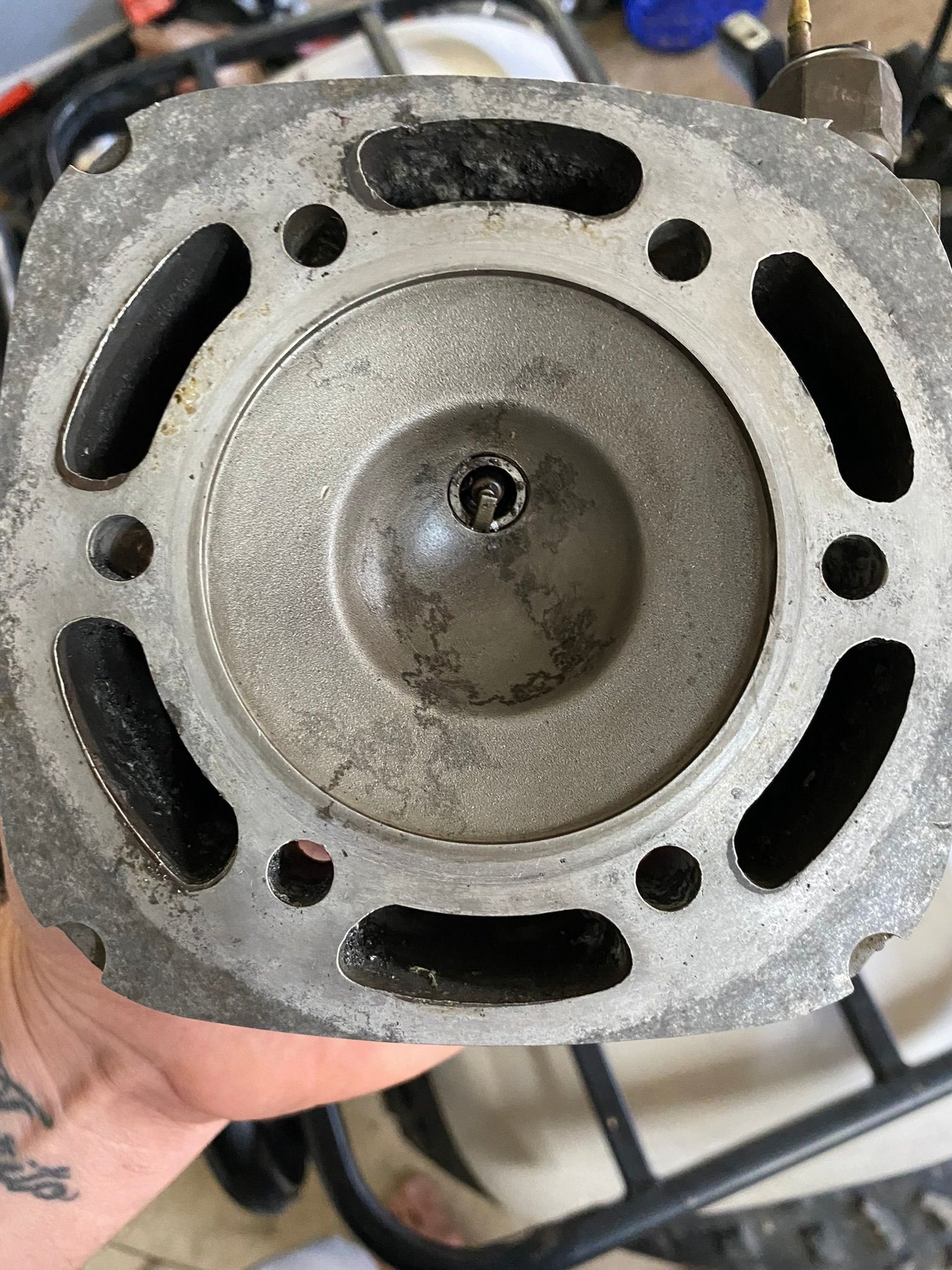

As for the engine, there is light surface rust in the cylinder and piston, I am currently taking it apart:
  • There was a ton of rust in the flywheel area, the rebound spring is Thanos'd by water intrusion. What is the likelyhood the lower section is savable?
  • If the internals of the lower section were exposed to water and rusted, is this savable?
  • There is a bit of distortion in the cylinder cap, these are cheap, but should I replace?
  • I understand what I bought haha, my theory was I could always look for a 400cc motor to rebuild and drop in.
I will also need to start sourcing covers and plastics ... someone tore this down and sold or lost a ton of parts. They also cut the rear fender drivers side off... So I need a rear plastic replacement.
Cleaned a bit, but you can just make out the wormy impression around 5 o clock
This was packed with wet rusty debris.
