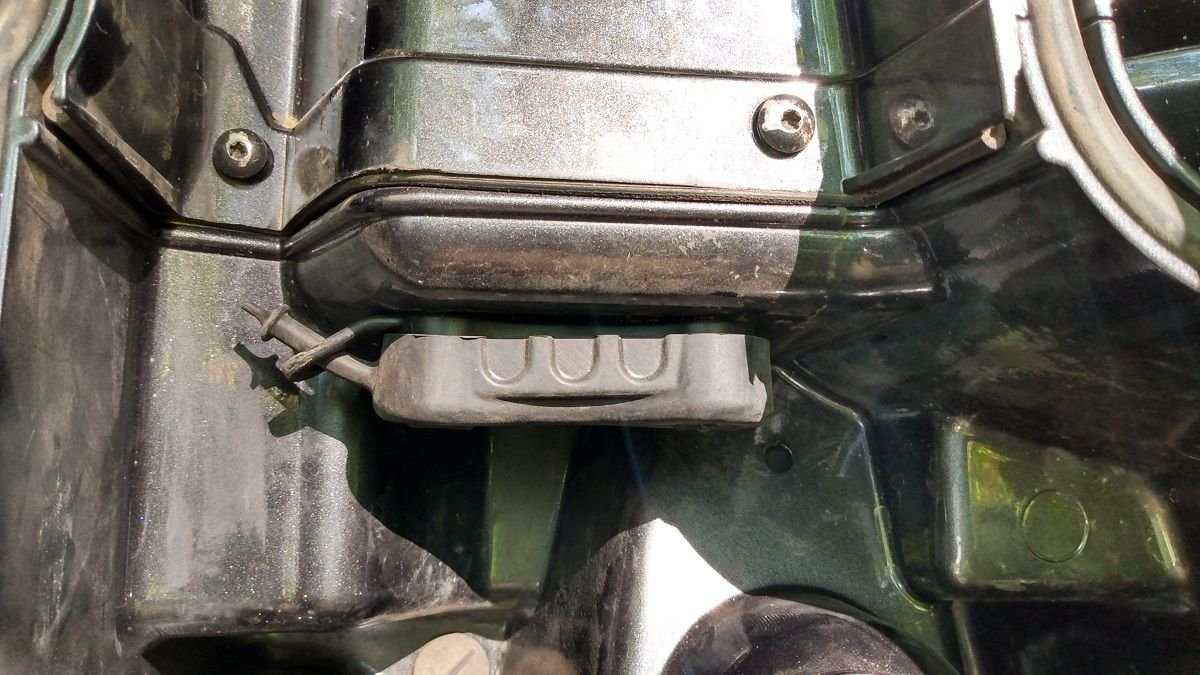

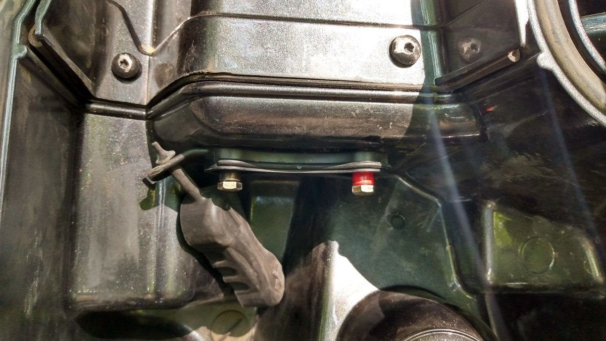

Hi, guys and gals. It's been a really long time since I checked in, and I don't plan on hanging around. I just can't find the time to be on more than one forum and that one's practically dead or I couldn't keep up. I just wanted to let everyone know about the Quicktap Battery Posts, Part 2882110, on clearance sale for 25% off. I had to jump-start my 570SP this past winter and it seemed like it was taking forever to get the battery tilted to the right so I could take the cover off the top. It was so late, I ended up not not getting my NOCO Genius booster on it until the next day. So when I saw this Polaris battery post relocation kit, I snatched one up. You hook the 2 cables to a busbar under the front cover in the middle of the cargo box, and drill 2 holes in the left side of the cargo box where it curves back from the center. Put the 2 bolts trough, put 2 nuts on, connect the cables with 2 more nuts, and connect the other end of them to the busbar. It your quad is like mine, there are already a bunch of accessory wires on there, and it will be hard to get the cables on. There just isn't enough length threaded to hook up every accessory Polaris makes, and half of them is a crowd. this is for all the 450s and 570s with the battery on the bottom of the frame, before they started putting a power port on them. I ended up dropping the nuts on the ground several times. They usually ended up somewhere in the frame or around the radiator, but sometimes they fell clean through. Most people won't have that problem.

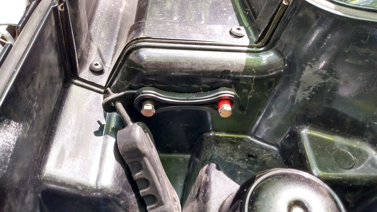

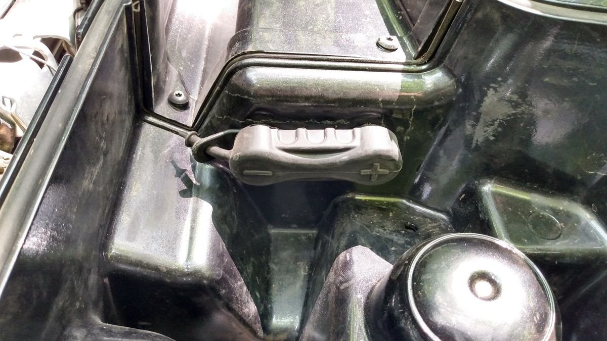

I finally remembered to take pictures of this over the weekend.

I had to use my 1,000amp NOCO GB40 Boost Plus to start the quad once over the 5-day weekend. The 4 year old battery is getting weak, so I carried the battery booster with me on the ride. This battery won't last 10 years like the maintenance free battery that came with my last Sportsman 500 H.O., but it may last through the winter. It was SO MUCH easier to hook the cables onto the remote battery posts than to try hooking onto the battery itself.
