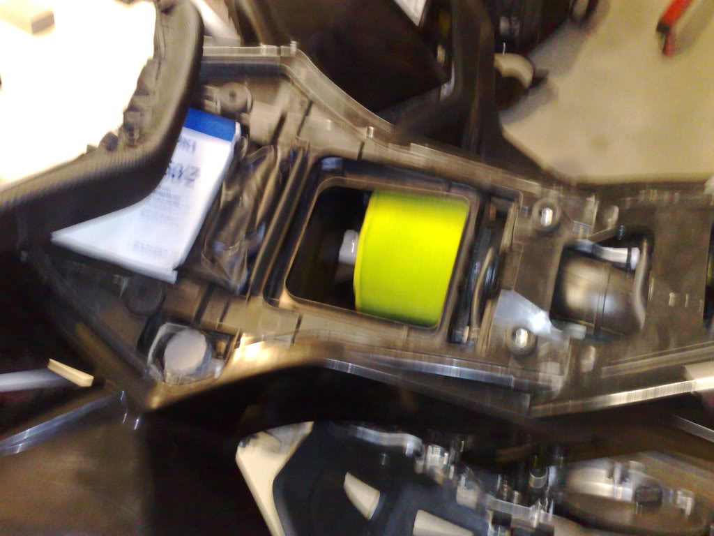

Just to clear it up... taking the airbox lid off means just the lid...
here's a pic of my LTR without the lid on.
Back when I was running the stock filter, of course (got a UNI installed now!).
