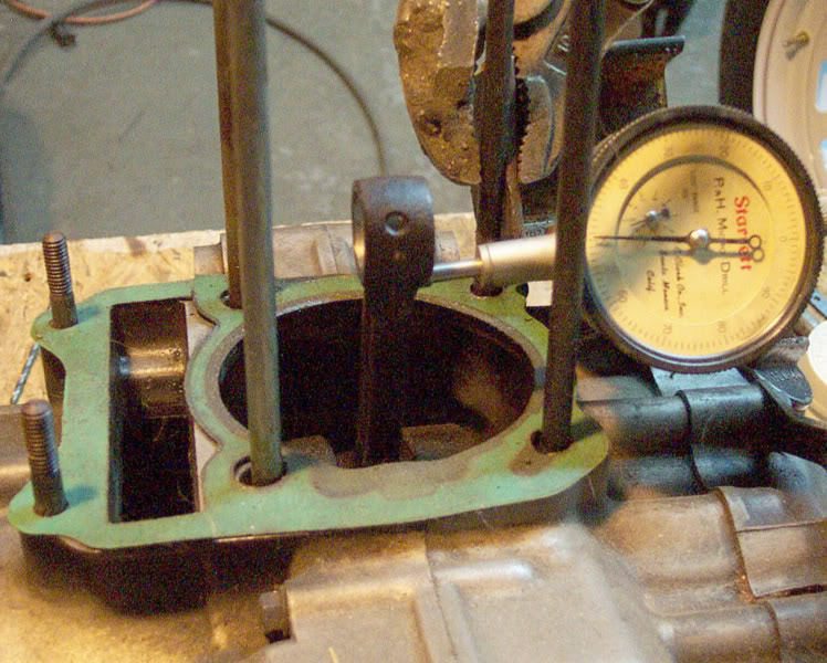

I went out n took some pics to try to show what I'm talking about. In the first pic I'm rocking about .050 side-to-side and I'm not even measuring at the very end like I'm supposed to. This is not counting the sliding motion.

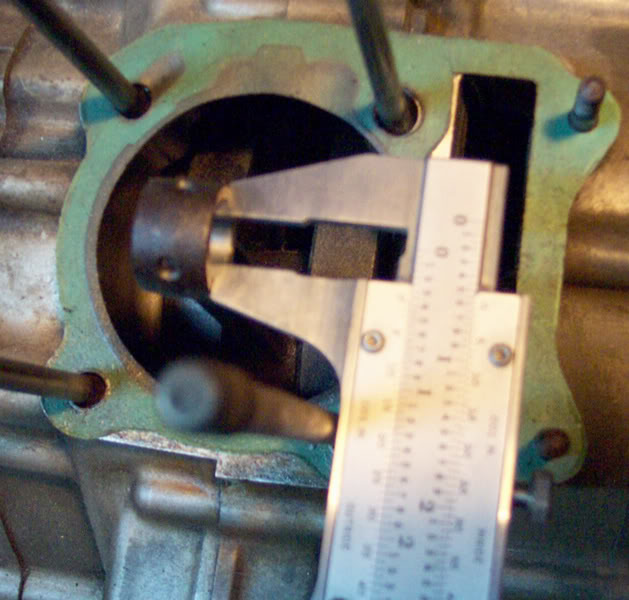

The next pic I'm out of round at least .004.
This is the engine I got one summer out of.
This was so bad that when I attempted to measure the deck height of the piston, I got different readings at the left and right side of the piston! And the bore had gotten so distorted that the difference in deck height between the front and back of the piston was huge. The piston was basically just flopping all over the place in the cylinder.
