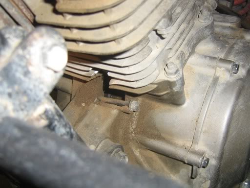

Yeah, if you can do all that at 16, I'd be impressed. So, if that's the case, take the crank out and send it to Vince for a new rod. That way, your bore will last a long time and you won't risk breaking a rod either.
Here's a friend of mine's engine after he put a brand new 260 kit in. He only got to ride it a couple hours and BOOM!

This set is another guy I met here on the forums. His rod broke the same week. Kinda scary huh?

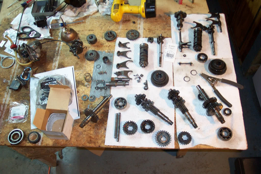

This is what mine looks like at the moment [img]i/expressions/face-icon-small-happy.gif[/img]

wow that first set of pics sucks to buy a brand new kit and have that happen. and yeah ive torn everything off my frame but never ripped the engine apart yet and vinces is an awsome site lol
