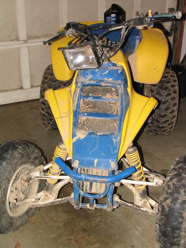

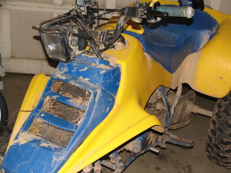

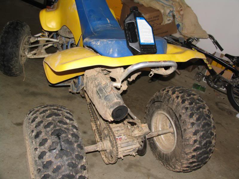

So I'm trying to tell what year this Suzuki LT250R Quadracer is. Is there anyway to tell? I don't have the actual quad in front of me so I can't look at the VIN. The only things I really have is these pictures as well as knowing it has a 6 speed transmission. Is there anyway to pinpoint the year?

the generations are grouped like this basically.
85-86.
87.
88-90.
91-92.
85 and 86 didn't have the powervalve and were only a 5 speed. the easiest way to tell the old motors is that their grey in color compared to the blue of the new ones. they had the easiest chain adjuster but are known for their weak frames.
87 i have heard is the fastest year but perhaps the hardest year the find parts for. the motor is different from all the other years slightly but i'm not sure exactly how. i believe the frames were beefed up a little for this year too and the frame is also a little different from the 85-86.
88-90. this year had the easiest time for getting motor mods. the motor was changed a little and so were some other things but i'm nopt exaclty sure what.
91-92 these years had beefed up frames as well as different shock mounts. supposedly this is the best year for the frame. i beleieve the motors are the same as the 88-90.

Its an 87 to 90 id have to see it closer to tell which

the motor is 88 up can tell by the reed cage can't get a good look at swingarm 91-92 swingers are diff

also thats not a stock intake boot looks like a old boyeson intake
