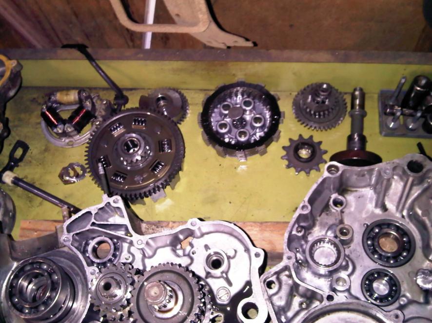

no promblem man if u need help on anythang els let me know cuzz i just rebuilt mine from ground up with a little help frome people on here and heres pics of the motor
Attached Thumbnails How do I rebuild my clutch? 1986 lt250r.-img00035-20100604-1354.jpg   How do I rebuild my clutch? 1986 lt250r.-img00036-20100604-1354.jpg   How do I rebuild my clutch? 1986 lt250r.-img00037-20100604-1354.jpg   How do I rebuild my clutch? 1986 lt250r.-broke-motor.jpg   How do I rebuild my clutch? 1986 lt250r.-broke-motor1.jpg
