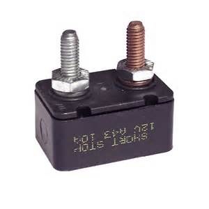

no spark to plug when using electric starter - Page 3 - ATVConnection.com ATV Enthusiast Community Plus cranking for an extended length of time can cause the main circuit breaker to heat up and trip,cutting power and then reset a little later. Could be the clicking noise you hear. It's located up from the battery in a sealed plastic pouch. Item#3 on this parts break down. Dirt Cheap Yamaha & Polaris OEM Parts & Accessories – Cycle Parts Warehouse Plus may not be a bad idea to check the condition of the 20 amp breaker by slicing the pouch open. It may be the main source of the problem. Cheap to replace at any auto store if needed for a few bucks. If corroded,it can kick on and off under a load. Couple examples of corroded breakers versus a new one.Hope this helps tracking down the problem.
