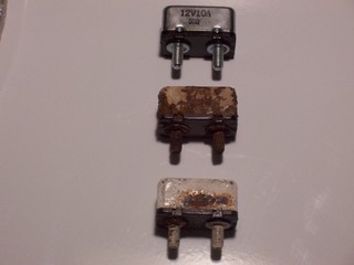

Look past battery going forward,should be a small plastic pouch containing the main 20 amp circuit breaker.Located usually close to the fender on the frame rail. Should have voltage in and out of the red wire. If not,slice the pouch open. Breakers can corrode and short out or just fail over time. Any auto supply should have these for a few bucks.
