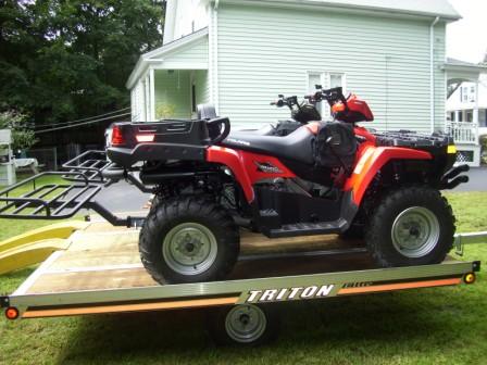

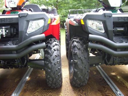

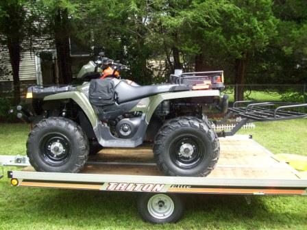

I went through this exact same situation back in August and went with the suggestion from one of the forum members. The ATV trailer in question to me wasn't going to work so I went with a Triton snowmobile trailer. Link below to the model. There were 3 models to choose from at the time and I went with the Elite series. Bigger tires, thicker plywood and more capacity. Couldn't be happier. I drive both machine right up on it from the back. There is about 10-12" between the 2 when up on the trailer. I have attempted to attach some pics so show how they fit.
