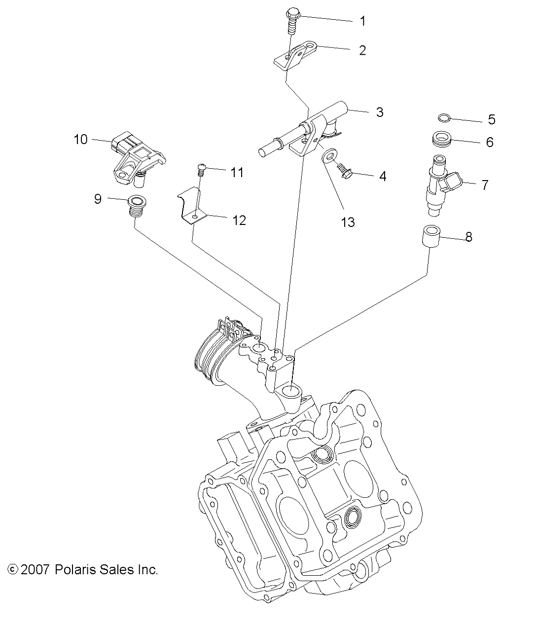

Make sure simple things like the throttle cable to the throttle body isn't in a bind,check the tbap and tps sensor wiring for any bare or soft spots plus a simple leak on the tbap grommet can cause idle problems.Hard to shift gears if idle is too high.If the grommet is worn or split replaced it. Item #9.
