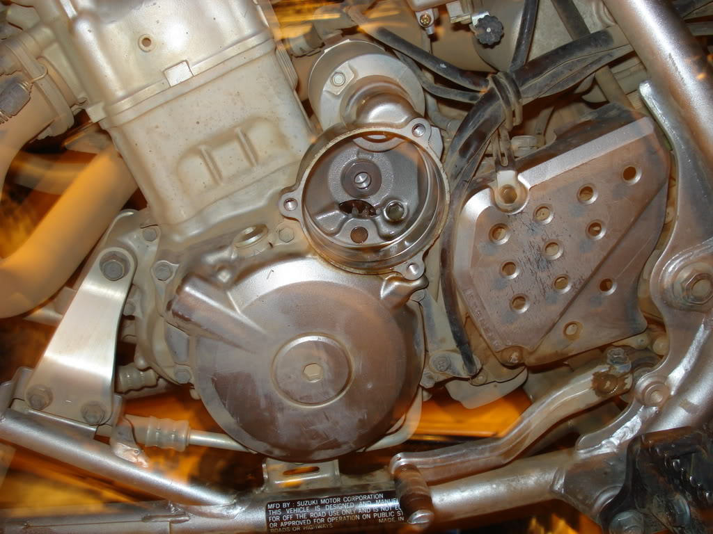

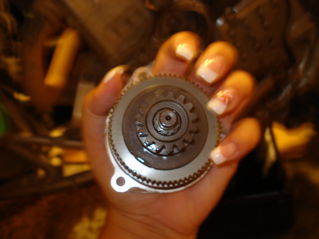

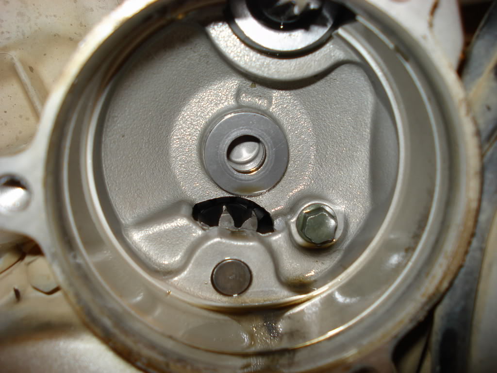

Old Jun 28, 2007 | 03:13 PM
  #80955
MotoQuadChick's Avatar
Joined: Feb 2007
Posts: 973
Default Puget Sound/Seattle/Northwest Area Riders Meet HERE!!!
I think its the starter gear and cover. I removed it thinking it was for the oil. I need to know how to get it to fit back in right and if it needs relubed..

<div class="FTQUOTE"><begin quote>Originally posted by: MotoQuadChick
Size:  135.7 KB</end quote></div>
That's the starter gear, put it back together. Your oil filter is on the opposite side from that. The oil filter will have three bolts in a triangle that will take an 8mm wrench or socket and the cover has a little arrow pointing up(or to the rear of the quad) so you know which way to put the cover back on when you change the filter.
Old Jun 28, 2007 | 03:28 PM
  #80958
LdyJay's Avatar
Preach it Brother!!! ;)
Joined: Mar 2005
Posts: 2,993
From: Warshington
You are looking at the crankcase side of the quad for that, BTW. The clutch cover side is the one with your oil filter

<div class="FTQUOTE"><begin quote>Originally posted by: LdyJay
That's the starter gear, put it back together. Your oil filter is on the opposite side from that. The oil filter will have three bolts in a triangle that will take an 8mm wrench or socket and the cover has a little arrow pointing up(or to the rear of the quad) so you know which way to put the cover back on when you change the filter.</end quote></div>
Yeah I know to put it back together but does it go in a certain way and what about lube....
