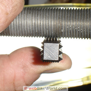

Find the thread pitch and a thread file might work starting the new threads on the end. If it doesn't help then having the correct metric die to remake the threads should.
Attached Thumbnails Threads on crankshaft? Help?-correct-fit-thread-file.jpg

Simple thread pitch gauge is available with any metric/sae tap and die set or by itself. Most auto stores will have them. Shaft would either be 1.25,1.50 or 1.75 thread pitch usually. Same for the thread file,can get at most auto stores. Has several different thread pitches on all 4 sides.Plus here's an interesting video that may give you an idea on how to repair damaged threads. If in doubt on crank shaft threads,let someone repair it for you.
