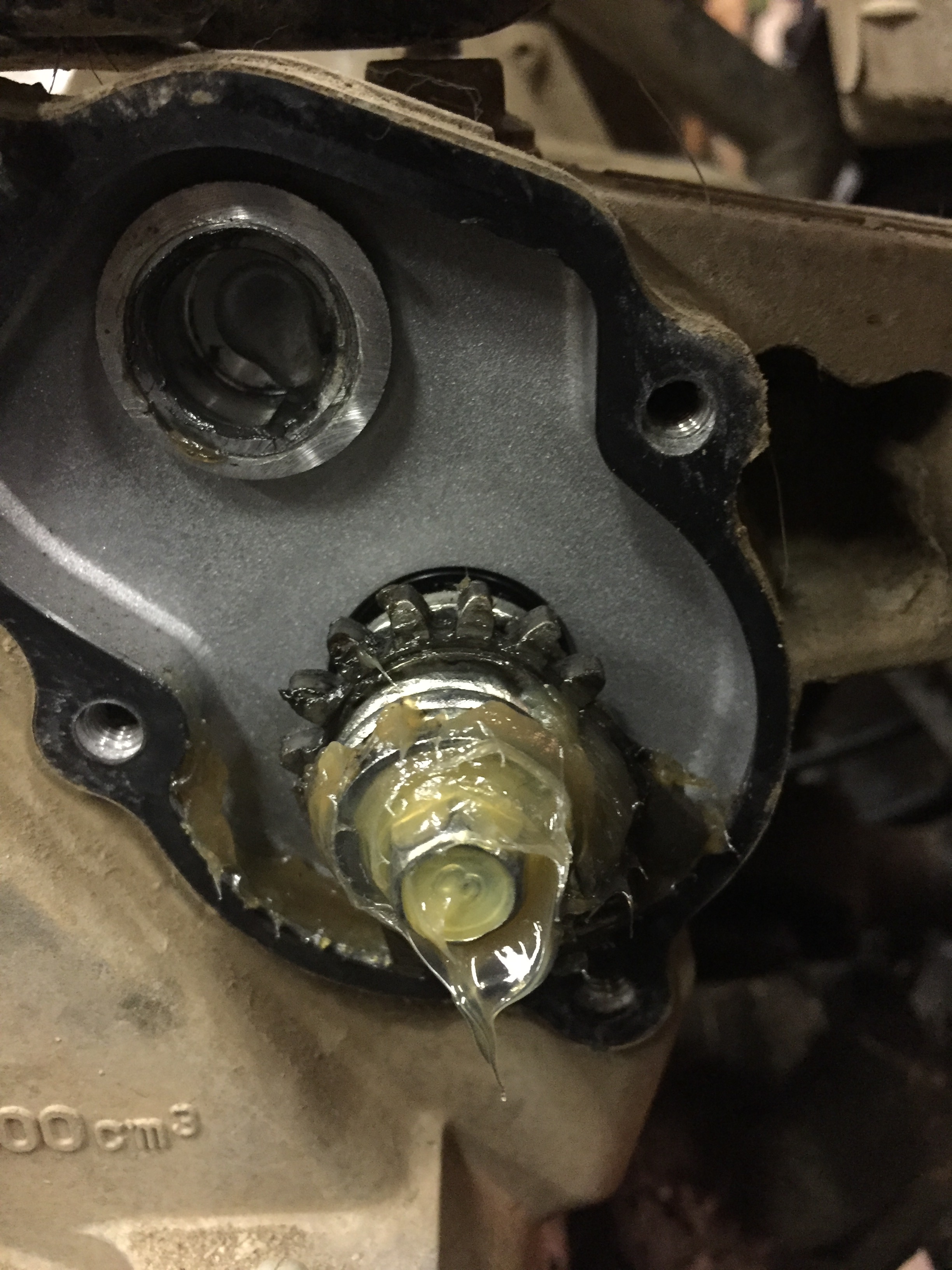

no I have the linkage disconnected as I thought that was the original problem been turning with pliers. wish I could figure out how to add pics
https://atvconnection.com/forums/att...1&d=1456418548
Attached Thumbnails 2008 Yamaha 450 grizzly won't change gears-071.jpg   2008 Yamaha 450 grizzly won't change gears-069.jpg

no haha I was just referring to the pictures worked lol. it still doesn't shift gears.

I even opened secondary all is good in there. So how do you get into the clutches? do you have to pull motor?
Old Feb 25, 2016 | 01:48 PM
  #20
Fasteratv's Avatar
Joined: Jan 2016
Posts: 591
From: Whitesburg, TN
I'm assuming this is a belt drive. The "dry" clutches are under the large black plastic cover on the side of the engine....I'm guessing there are about 8 bolts that holds the cover on. Once the cover is removed, you will see the drive and driven clutch as well as the drive belt. But before you go to that trouble, have you "googled" the issue you are having and read everything you can about it? I say this because I'm "guessing" you may have a clutch issue. I have never seen what you have been describing....tho I have worked on ATV's for many years.
