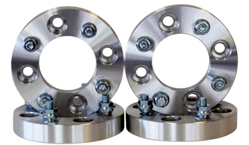

When it comes to widening an ATV, there are really two approaches. The simpler and cheaper way is to use wheel spacers to achiever a slightly wider stance. However, if this is a machine you are planning on keeping for a while, the best choice would be to buy and install wider aftermarket components.

In the rear you have essentially the same two options- to either run wheel spacers for added width or to purchase a wider axle. Since the rear of a sport quad need never turn-in or change angles like the front, we would be a lot more likely to go the cheaper and simpler route of wheel spacers here.
Spacers
In fact, the best approach on a budget would likely be to opt for wider a-arms in the front and a pair of spacers in the rear.
