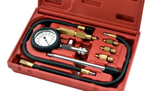

To perform one, pick up a cylinder compression tester like the one shown above. A ATV-specific set will set you back around $100 but it’s one of those tools you buy once and can use with any machine you own for a lifetime. We’ve also had success running much more affordable motorcycle testers that were only $20 at the auto parts store.
Take the threaded probe and, once you’ve removed your spark plug, hand tighten it into place. No need to torque it with a wrench. Note that this could potentially be the most difficult aspect of the whole process as some ATVs have very little clearance. We’ve had some that we could attach the tool in twenty seconds flat and others that required the removal of the gas tank.
