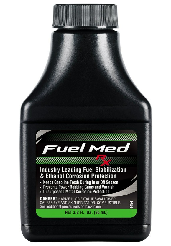

We’ve been using Yamahalube Fuel Med RX up here for NY winter with impressive results. While E10 is the norm (10% ethanol) around here, the Med RX provides metal protection for E15 and/or E20 fuel should bureaucrats continue pushing for corn grower agendas.
While we can’t speak on the effectiveness of all of the brands out there, just be sure to do your research before storing your ATV this winter. Look for a formula designed for use with ethanol-enriched gasoline. Make sure it is designed to prevent ethanol fuel corrosion protection for metals and aluminum fuel system components.
