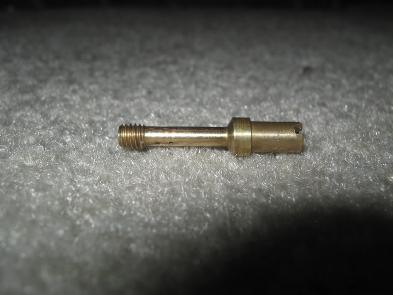

Ok checked the jets.
Main has no markings at all.
Pilot has "435" on the side.
I also stated looking at jet online and I have not been able to find a Kelhin jet that matches my Pilot Jet. The threads on mine are at the bottom and the replacements seem to be in the middle.
The carb is a HuaYang and appears to be identical to the PZ30 on my Cool Sports 200cc I don't have a micrometer to measure the intakes. Any suggestions?

Has anyone had the same problem with their jets? Any suggestions? Do you think the pictures are just wrong on the suppliers website?

Ive never seen a jet like that...gotta love the Chinese... you could always drill them out in small steps... do you know anyone with number 1-60 and 61-80 drill bit sets?
