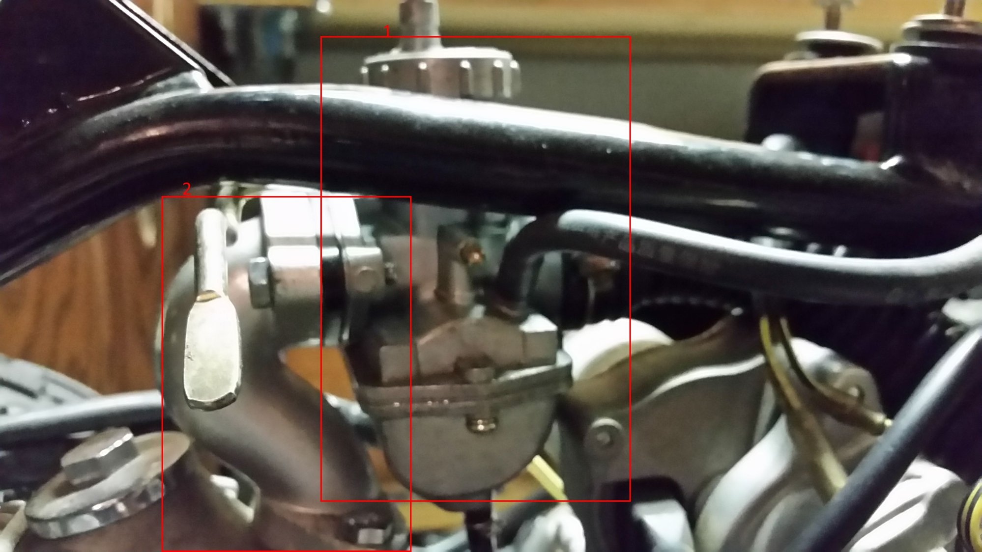

5) Please see the image below. Do I need to remove both rectangle 1 and 2 to work on the carb or removing rectangle 1 will be enough?

I've made some progress and this is where I am. I've cleaned the carb, replaced the fuel.
Right now the quad starts and runs but ONLY with choke ON and the throttle has to be pressed. As soon as I turn the choke off or release the throttle the bike dies.
What is it? Do I need a new carb? Please advise. My son keeps asking when he can ride it

You are still not getting enough fuel, probably a clogged idler jet. Regarding the drain plugs, one will be the cam chain adjuster, I and a great number of others have mistaken this for a drain plug and got a surprise when a long spring and plunger shoot out, trouble is, I can't remember which one it is. Go for the plug that doesn't line up with the cam chain. Someone answered the wiring plug question earlier this year in a post, it is ether for fitting a trickle charger or a diagnostic plug, can't remember now, nothing important anyway.
