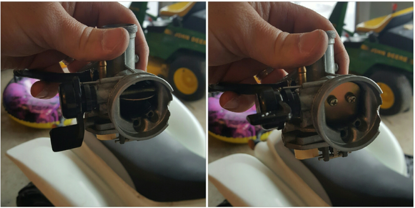

One of the main problems I am having with this quad is starting, it almost takes a full battery charge to get it started. I have cleaned the carb and replaced the air filter and spark plug. Still a bitSpam wordSpam word Spam wordSpam word Spam wordSpam word Spam wordSpam word to get started. I want to replace the carb but want to make sure I get the right one. Also, the rectifier started smoking yesterday, may have had something to do with me attempting another battery (same size) but wiring the negative to positive and trying to start - maybe fried the rectifier. I have two on order to replace. I can attach pics of the carb if needed.

I posted a couple more pics of the carb and the engine placement. I am going to assume this is a Horizontal. But we can confirm it is a 125cc, correct?
I am thinking of replacing the carb, would it be a PZ19 or PZ20 or something else?

Yes, it is an E22 Honda Cub clone. I've always got away with adjusting valves using a normal spanner and a pair of pliers. You can't go far wrong at 0.003" on these little engines. Take a look at those videos, and ensure you are checking the gaps with the piston at top dead centre on the compression stroke. As for the carb, it looks like new so I would expect it to work fine if adjusted right. May be worth blowing the jets out with compressed air, and ensure you haven't lost one of those O rings between carb and inlet manifold.
