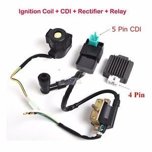

I went and bought a new stator, cdi solenoid and flywheel, cost me all of about $65. I am yet to fir the flywheel as I can't find a way to lock the crank to undo the nut, but it seems to work ok now I have cleaned it up. I have rewired it some - removed all the lighting crap and the millions of kill switches and gave the loom a general tidy up as it had been hacked by someone by the looks as one of the safety switches caused a dead short when activated. I plan to refit these safety once I have spark back. I have followed the wiring diagrams I can find and apart from the short in the safety switches all the wiring seems correct.
I have stripped it down to basically an ignition key which supplies power to the start button and thats it, ive taken the center wire off the cdi for now so no kill switches are possible, ive checked the trigger wire and the ac output of the new stator and continuity of the earth - all good, CDi is brand new so hopefully good there, wiring all was good there.
So now i have the starter working off the key and then the button, but still no spark, have tried a good sparkplug from another running motor..
Last thing in the chain is the coil, the primary side tests at .5 ohms and the secondary is about 9.8kohm .. Im thinking this is the problem as I believed the primary side was meant to be about 3-5 ohms and the secondary 12k ohm + or so.. can anyone tell me the specs for one of these coils on the 110cc gems ?

Bit more info after reading a few threads on here, I have the 5 wire stator, the 5 pin CDI black with the green plug.
should there be power from the ignition switch - ie from the battery going to the CDI ? Im pretty sure i checked and I don't have 12v with the key on anywhere on the cdi plug. but some threads its seems to mention that there is..

this is the electrics I have
