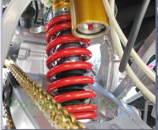

Does anyone have an NST 250cc quad. (please veiw pics) what type of engine is it, is compatiable with other know motors.
1. How to adjust the rear shock
2. What oil should i use
3. is there a bike whos parts are compatable for perfomance.

The engine looks like the pushrod CG series of motors. I believe it will be called a CG250. It has a manual clutch? 4 forward gears and reverse, or 5 forward gears?
I have a CG200, which is a 200CC version of that motor, it is a honda motorcycle bike engine design. I use Castrol 4-Stroke oil made for motorcycles (Called Castrol 4-Stroke 10W40). This motor has a wet clutch and needs oil meant for this, most motorcycles have wet clutches.
The rear shock is adjusted by tightening or loosening the 2 nuts on the top of the spring (1 is to lock the other nut from loosening off by itself). Apparently the shocks are adjustable too by the air fitting, I have these on mine, I wanted to check the air pressure in them, and got a spray of oil all over my pressure gauge, so I dont know how to adjust the shock dampening.

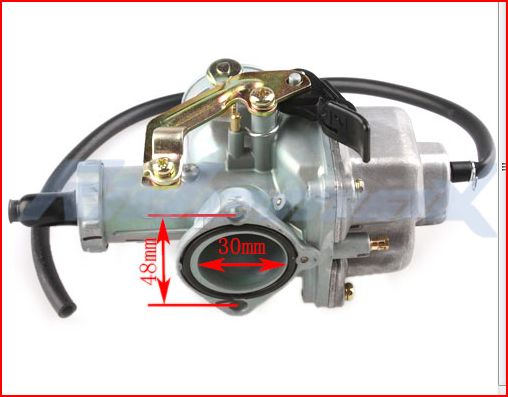

Did you jet the carb your self. Was their a significant gain?
here is a pic of the carb thats in my bike now. is this good?

have one jus like that i took to the shop and had some carburetor work done. i change the jet to 115 for summer and 120 for winter and put a D&G slip-on exhaust on it and man i feel the different. it runs a whole lot better. jus small changes make a different. try it !!!!!!!!!!!!!
