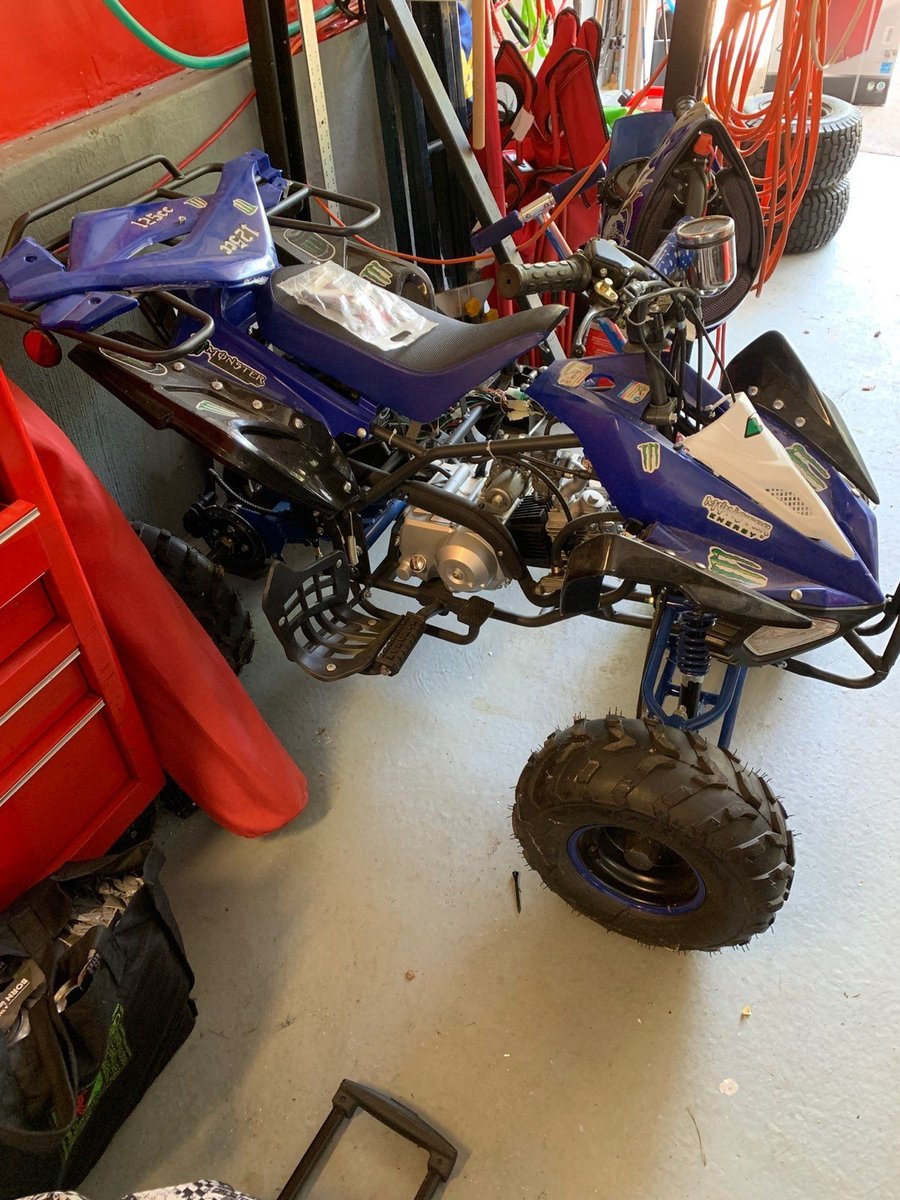

Just picked up a Chinese 125cc atv and need a new fuel tank because the one that came with it leaks at the seams...

Amazon or Ebay.. i tried the taotao site with a different machine and took forever to get the parts. Amazon the parts are here in a week easy... Do yourself a favor on that machine change the carb out to something that is serviceable. I just had to do that with mine as the little one decided last min she wanted to ride it after a 1.5 years and last min of course.. Would idle all day but run out of fuel under throttle and cannot take the bowl of the stock carb to clean. Also install a fuel shut off as the dont have those as well. They are a good machine it started right up after sitting for so long but i do keep the battery on a maintainer as well

Thanks for the reply. I was able to fix the tank by pressurizing it and spraying it with soapy water. Found one seam on the rear that had some pin holes. I jb welded it and it’s no longer leaking!!
So once I put it all back together I tried starting it and it won’t start. If I spray some quick start in the filter, it will fire up quickly. So I’m assuming the carb is gummed from sitting for so long.
I just ordered one from amazon.

Ya i just ordered a carb for the same reason... 3 days and its here
