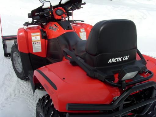

I had to run a dual battery set-up on my TRV to run my Gorilla winch BEACUSE of all my "other" accessories that I had running - headlights/dual plow lights/beacon/handwarmers/bkup light.
Even "dual'd" up I ended up dropping my beacon & headlights. The winch requires a HUGE amt of voltage to run. I can usually run about 2hrs max before I notice that EVERYTHING dims.
As a result I put a 1.5 amp battery maintainer on my batteries ALL WINTER on a timer, so they're full charged everytime I need to push snow.
Attached Thumbnails Winch needs HELP-accesory2.jpg   Winch needs HELP-accesory1.jpg
