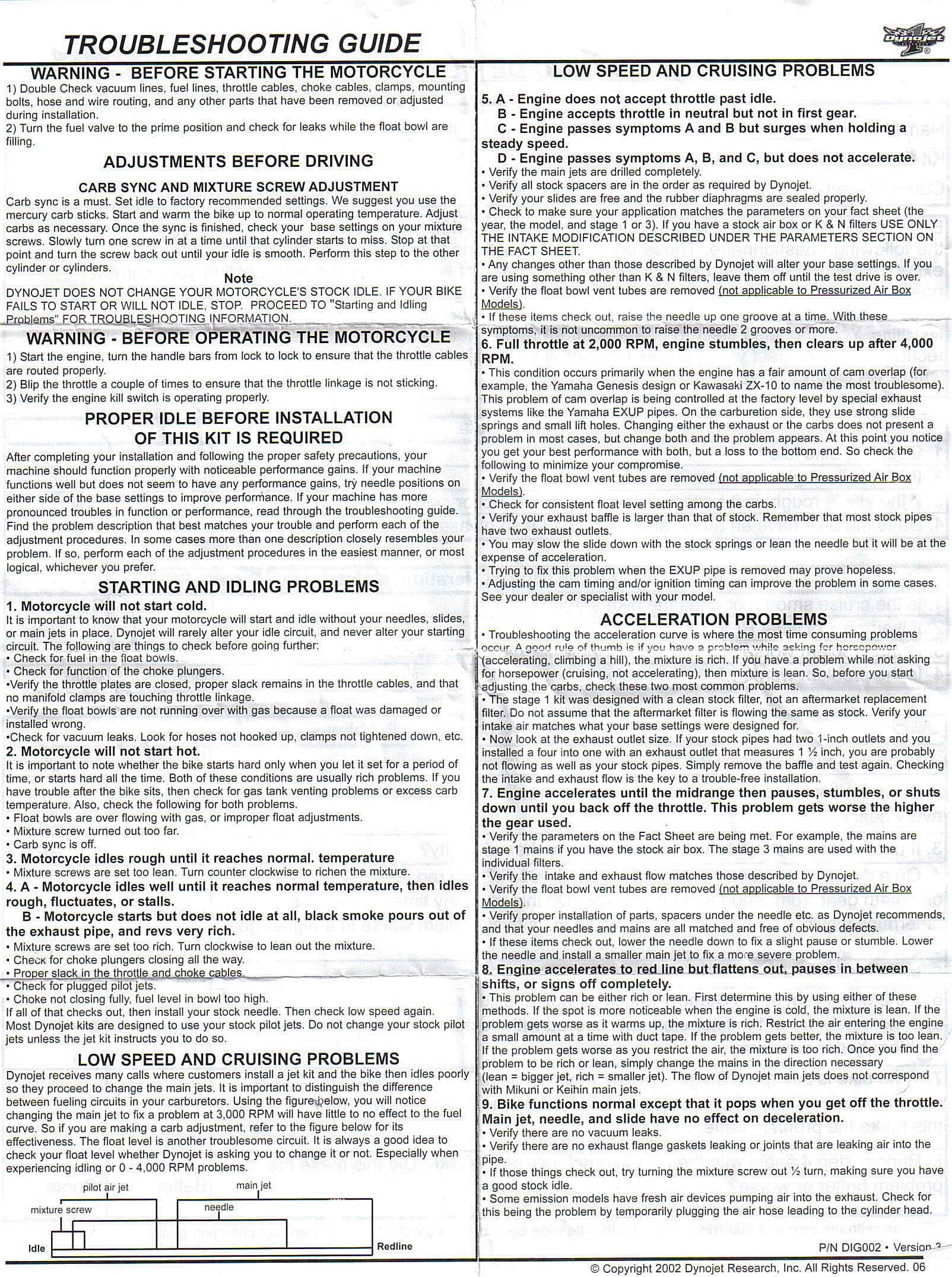

Check the rubber boot between the air box and the carb for cracks, replace if you find a crack. That will make it run lean plus suck in dirt. Normally, I would say check for a speck of dirt in the pilot jet. Is the PMS screw turned out 1-2 turns? Float height set to 17 mm?
