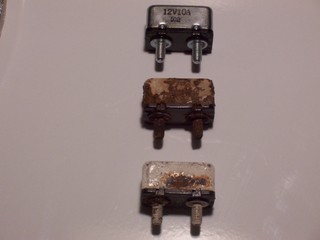

Did you check to see if the 20 amp sealed circuit breaker has power on each side of the red wire? Usually this breaker is first line defense on keeping damage from going to the dash,speedo,lights and modules when hooking leads up wrong,power surges,etc.If it doesn't have 12 volts on each side, split the pouch and check out the breaker. You can get them at any auto supply. Plus they can go out on their own when corroded or old. Locate up from the battery on the upper frame close to the left rear fender usually.Item #2 on parts list. Plus here's several breakers from new condition to corroded.
Attached Thumbnails 2000 Polaris Xpedition 425 Speedo problem-index.png   2000 Polaris Xpedition 425 Speedo problem-1000936wj9.jpg
