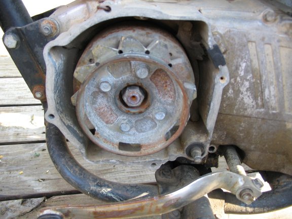

The pull starter assembly is completely missing. I am geting the entire essembly but it's a 3bolt pattern. The crank case has 4 bolt pattern. Is one of the bolt holes not used? is there another piece ?i will need?
starter area
there is a cable missing that goes to the decompression linkage. Where would it connect form there?
decompression
This is the ignition section. i don't have the cover yet, but the bolt is loose. is there something that is missing from this area?
ingition area

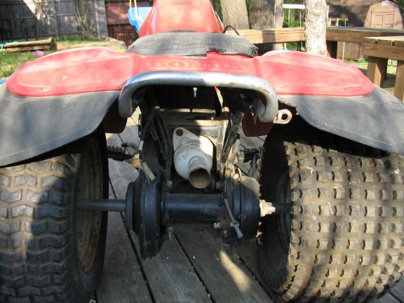

I'm missing the rear brake lever that the cable goes too. any clue where to get one? the photo shoes the entire rear section.
rear area
starter area
decompression
ingition area
rear area

On the pull start there are only 3 bolts used
There is a decompression cable going from the pull start to the cyl head
In looking at photos I see your spark plug wire is missing
I see allot is missing
But it looks repariable
I can see some work will be needed to get running as it has been out in weather
