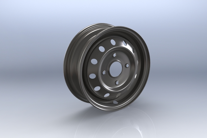

https://d2t1xqejof9utc.cloudfront.ne...2f5/medium.JPG
This is the rim that we are using

The tire width is 8 inches and your tire rim is only 5 inches wide. The tire will not work.

It will stretch across, but your sidewalls will be weaker. Not something I'd do if I were doing a baja. Or anything for that matter.
