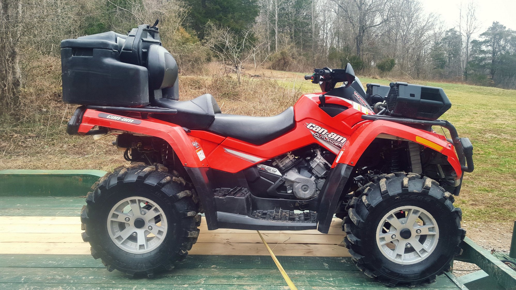

Alright guys... the wifes 2007 650 outlander maxx xt is not working. Dropped it off at a well respected/looked up to friends house for him to replace an axle boot for me and change the oil. He went to start it up and called me because it wouldnt start/the gage clustee wasn't coming on. (Basically asking me how i start the thing) . Went over to his house to pick it up and we looked over every fuse, unplugged/replugged every connector i could see on machine. Still nothing. Jumped the bike off a truck still nothing. We took battery off and put it back in to make sure Terminals were getting a solid connection (and they are). With the key off and kill switch in OFF position when we plugged battery back in and a relay up front and what i believe to be fuel connector on side of motor was making a clicking noise while OFF. Turned the key to the ON position and cluster lit up for a few seconds and went off (wont come back on). Tried starting, nothing. Rear taillight powers on.. front headlights are not. What's going on guys? Only has 570miles on this machine. I'm frustrated and dumb felt that i cant figure out whats going on.

that`s a nice looking bike. sure seems to be a lot of can am and Polaris elec. troubles, all the forums are full of them. old Polaris tech can probably help w/ this !

Yep, darn, thats a sharp ATV....for sure. I would help but I just don't know much about Can-Am. About the fuses and fuse holders...were they clean and dirt free? I might recommend that you remove each fuse, one at a time, clean the fuse holder and fuse ( did you check the fuses with a meter ), slightly bend the fuse blades to help ensure good connection, and check the fuse holders to ensure that the "female" portion on the fuse holder has not been "pushed" away from the holder. Also apply dielectric grease to each fuse while your in there. Since the panel "lit" up once, it kind of seems that its a connection issue. I hope this helps you in some way.
