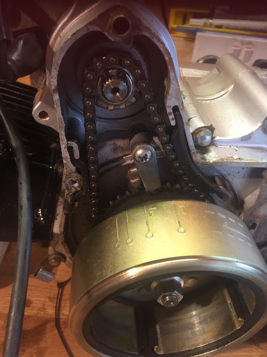

I have taken some pictures of what I mean about the timeing if you look at the fly wheel you can see it has 4 marks I'm not quite sure which one I should use

As you can see from the bottom picture that looks pretty spot on to me but the top picture has so many markings I'm not sure which to use and I can't see any where to line it up on the casein either

T is top dead centre, F is for checking the spark, though as it is fixed, many newer designs don't have this mark. Not sure what the others are. Are you sure you got the flywheel on the key, I seem to remember they can be tricky to get on without the key sliding out. The straw test will show if you have it wrong, as TDC on the piston should coincide with the T mark.

The cam timing in your pic looks to be off the mark. Enough to cause a problem if it is. Looks to be off by at least one tooth.
As mentioned, the "T" mark is for TDC, but I can't tell where that mark is supposed to line up. I would check the flywheel key is installed right, then find TDC and see where that T lines up, just to reference a fixed point so it can be used when the cam timing is reset.
