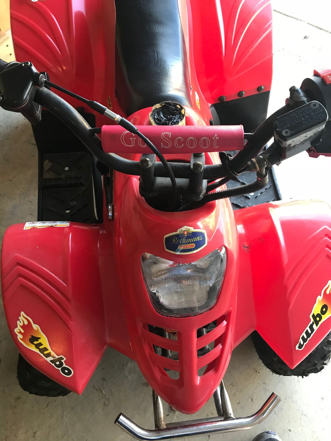

hello folks, new here. I bought this little Chinese deal for my son last year and have yet to be able to determine what make it is. Can anybody help?

There's a VIN plate on the frame close to the right rear wheel. The one that I have that looks like that was sold as a different brand than what it said on the plate, that's probably a coolster. You can't tell the size of motor with looking at it. It can be a 49, 90 or 110. That should be printed on there too. If it's not, it's stamped on the lower cylinder head and probably reads 107cc

That looks like a date and serial number for the frame. There should be a proper VIN and possibly makers name plate somewhere. Does it matter? The engine looks like a standard Honda Cub clone, from what you can see on the photo.
