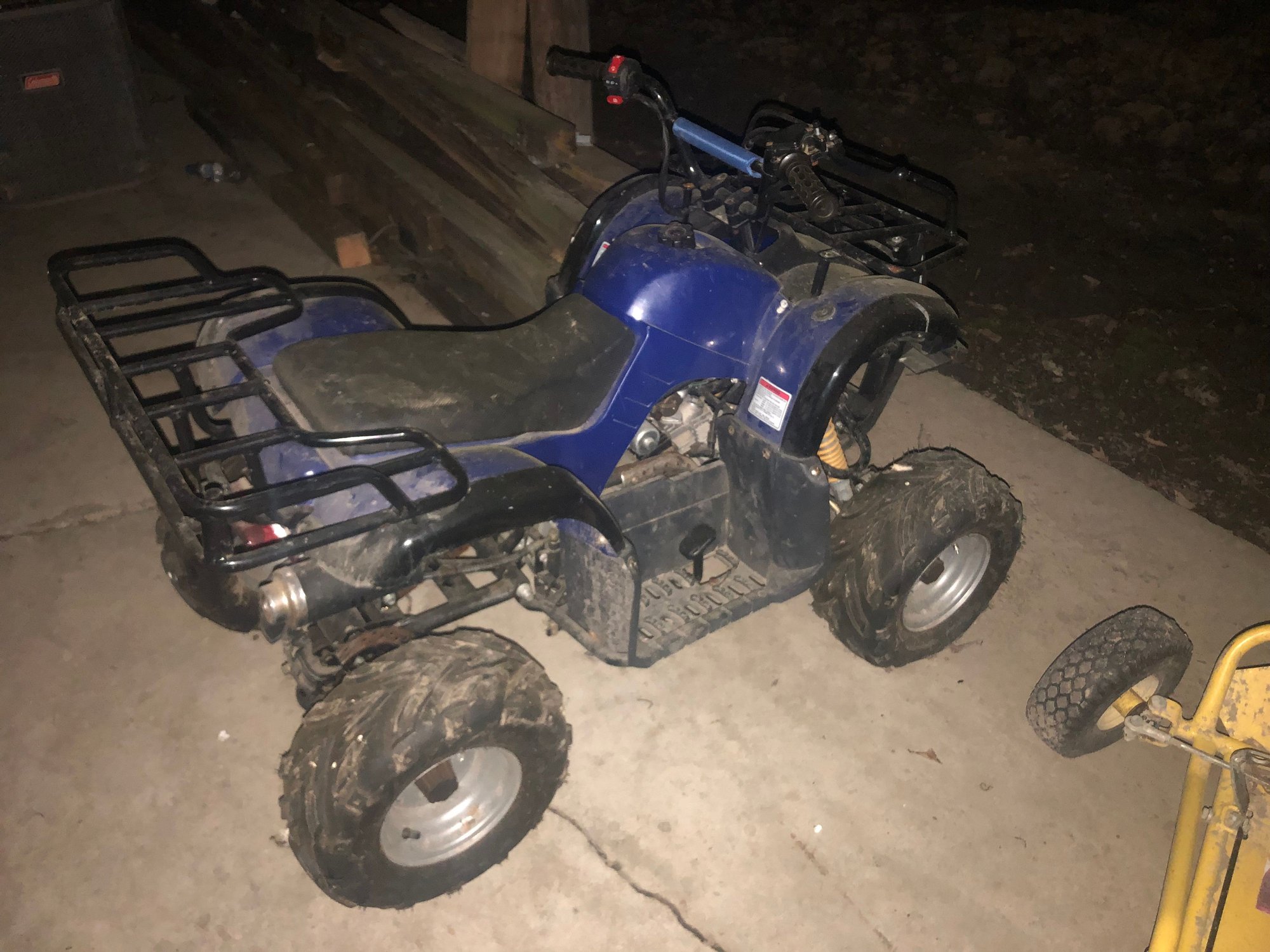

Hey! I inherited a taotao 110 atv from someone for my daughters. I got it running great but can’t figure out if your supposed to be able to shift it into neutral/reverse??? Looked it over and nothing sticks out to me. Did they make these that only went forward?
thanks!!

Looks like it is just "rev and go" no reverse. A lot of kids Quads are, and none the worse for it, as Chinese reverse gearboxes tend to be fragile and give trouble. They roll easily so, if you need to reverse, get off and push.

Yes no reverse only 3 speed forward I have one that my daughter has ride for 6 years
