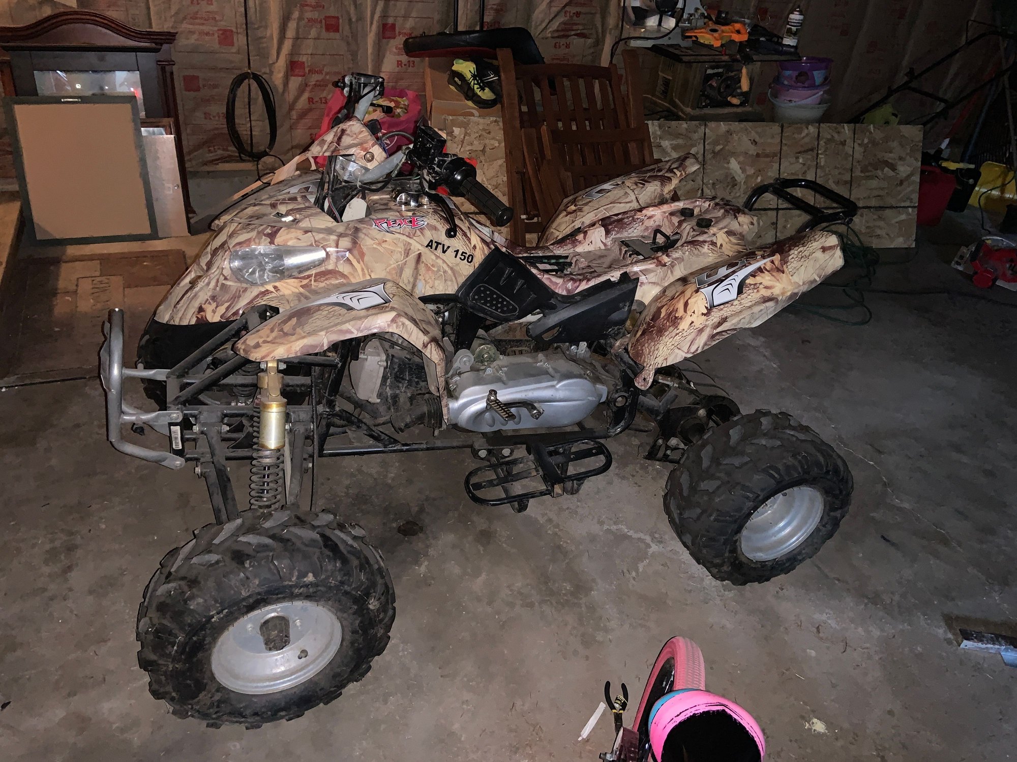

I just was given a 150cc quad which I think is a Chinese model either a Tao or Coolster I think..... i don’t know the year or model or anything so I was hoping to get some help. Oh it also won’t start. Today when I got it I kick started it cause battery for electric start was dead it started. I pull it out and drove it. It did not have much power and did t seem to go more then a few mph. Then I pulled in back into garage and it died. I couldn’t get it started again. Because it has been sitting I think the carb needs replaced or clean, but why no power or mph? Carb?

i would start by cleaning or replacing the carb... thats a older model so its been sitting for some time.. Also looks like the the piping for the air intake to the belt housing is missing so the belt could be toast if its been taking in waster and mud before it was parked

Piping for air intake? Can u be more specific this is my first one and not familiar. The model has on the right side a forward and reverse lever as well.

There also seems to be no gas line shut off I don’t know if that is normal

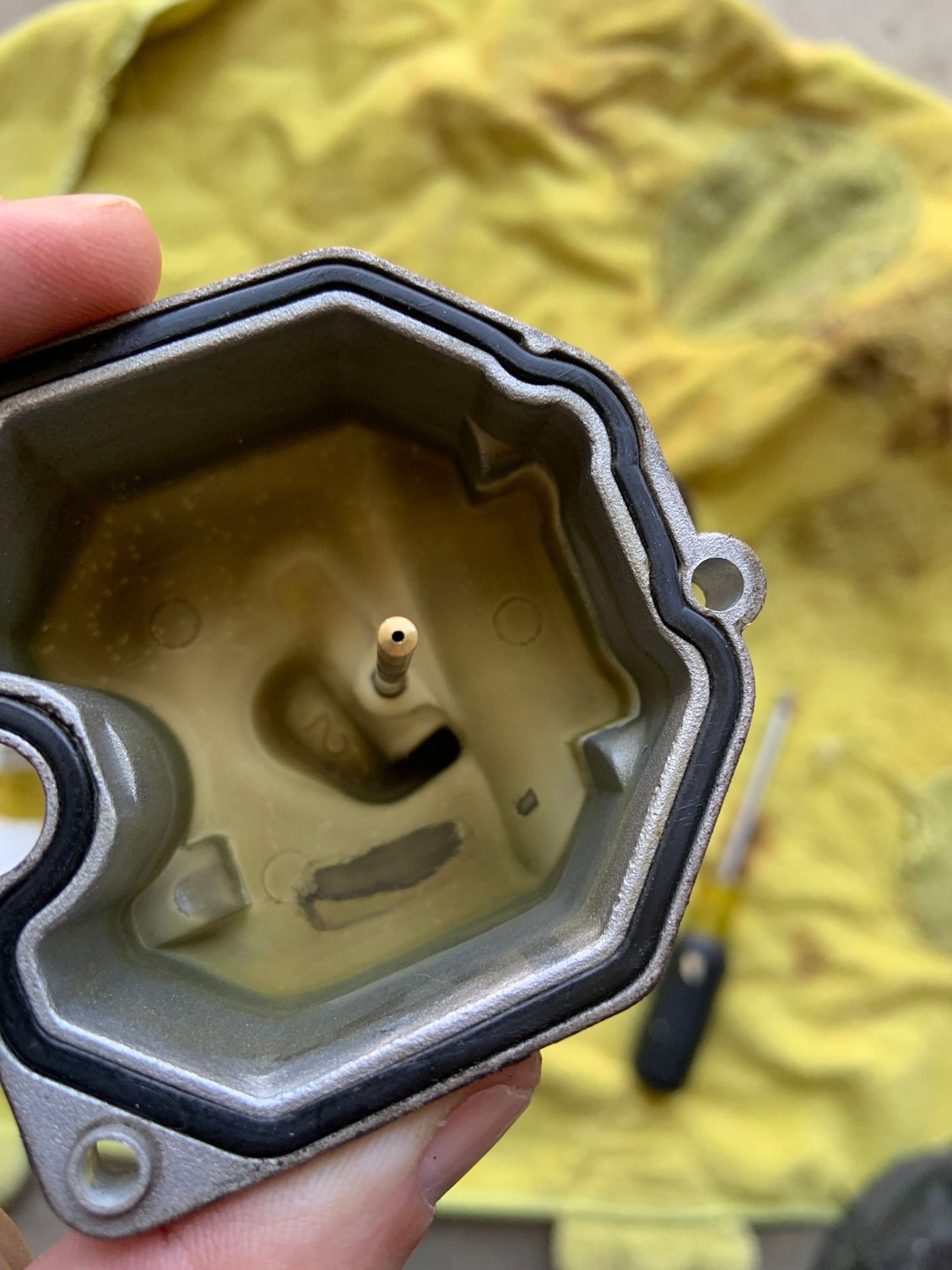

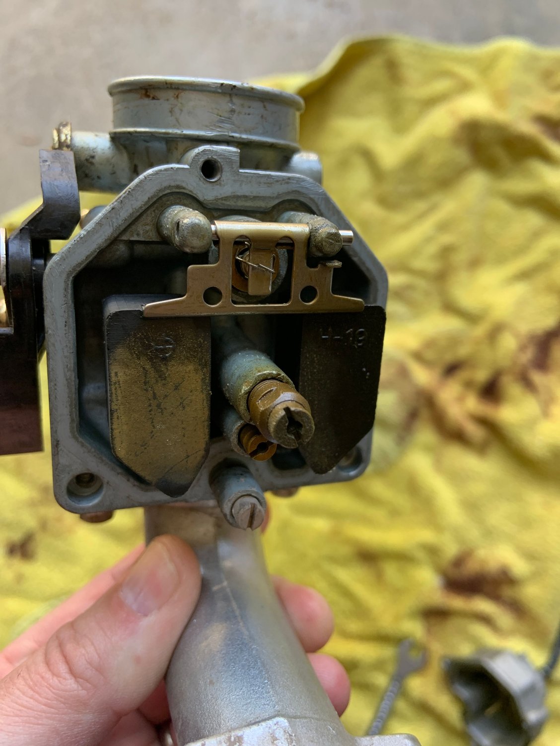

I have the carb off and apart what exactly am I looking for.
Old Apr 20, 2020 | 12:41 PM
Kymco 450i's Avatar
Joined: Jan 2016
Posts: 2,491
Likes: 46
From: Perrysburg Ohio
This is where a rebuild kit comes into play, they have insteuctions included....the carb needs to be completely dissassembled and cleaned, all passages blown out, new gaskets on reassembly and foat levels set to specs after installing new needle and seat.
