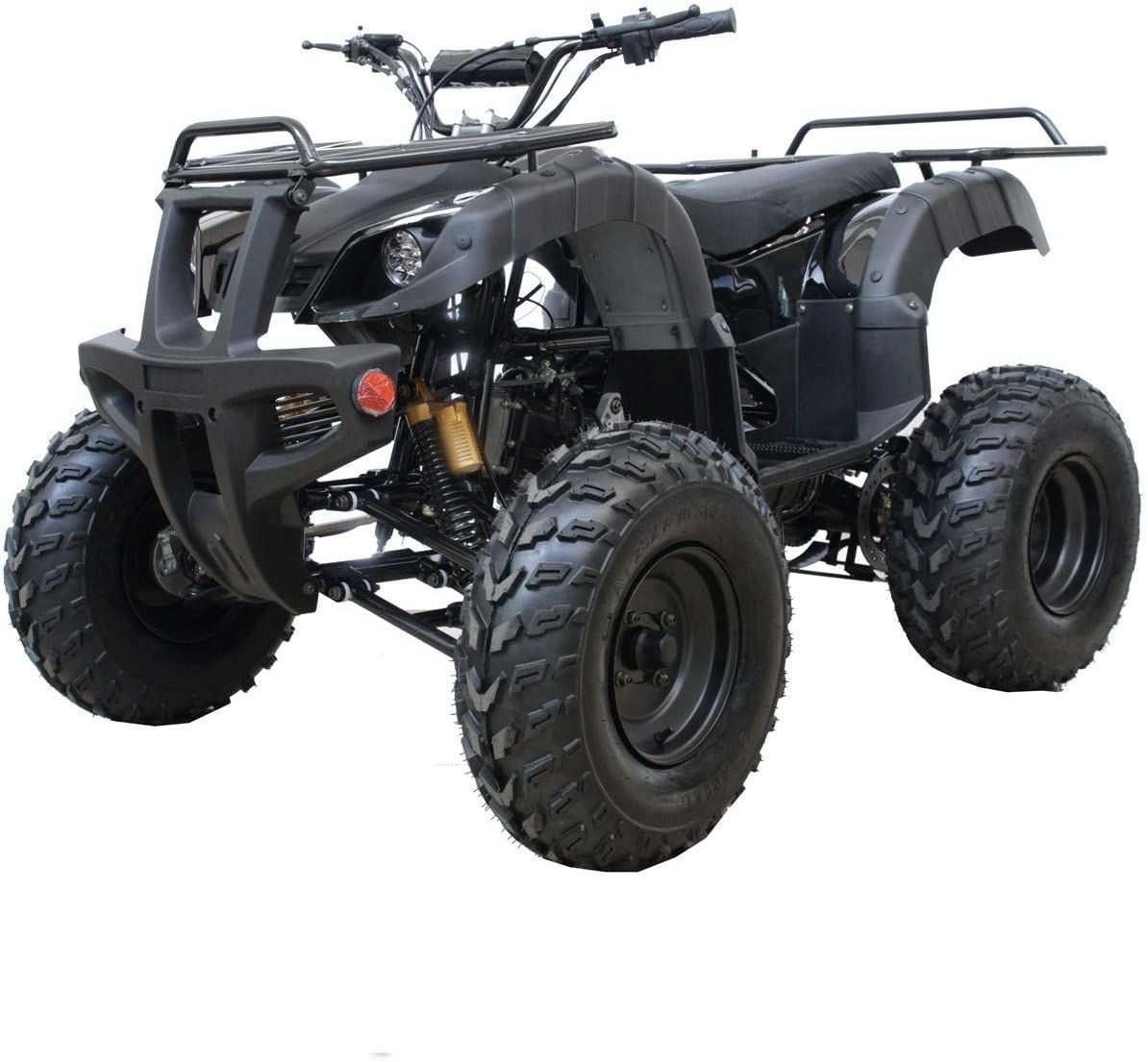

Hi there, I have an issue with a competitive ATV company, X-Pro, Moto pro from Amazon. I have this clanking noise that I can't tell what it is or where it's coming from. I think it's the engine. What would you charge to look at the videos and give me your opinion?

Have you checked the chain? I had an old bike many years ago with a stretched out chain that was over-tightened and it made similar noises. You can mark the chain when it goes around the front sprocket when it makes the sound and see if it does it each time a marked area passes.
