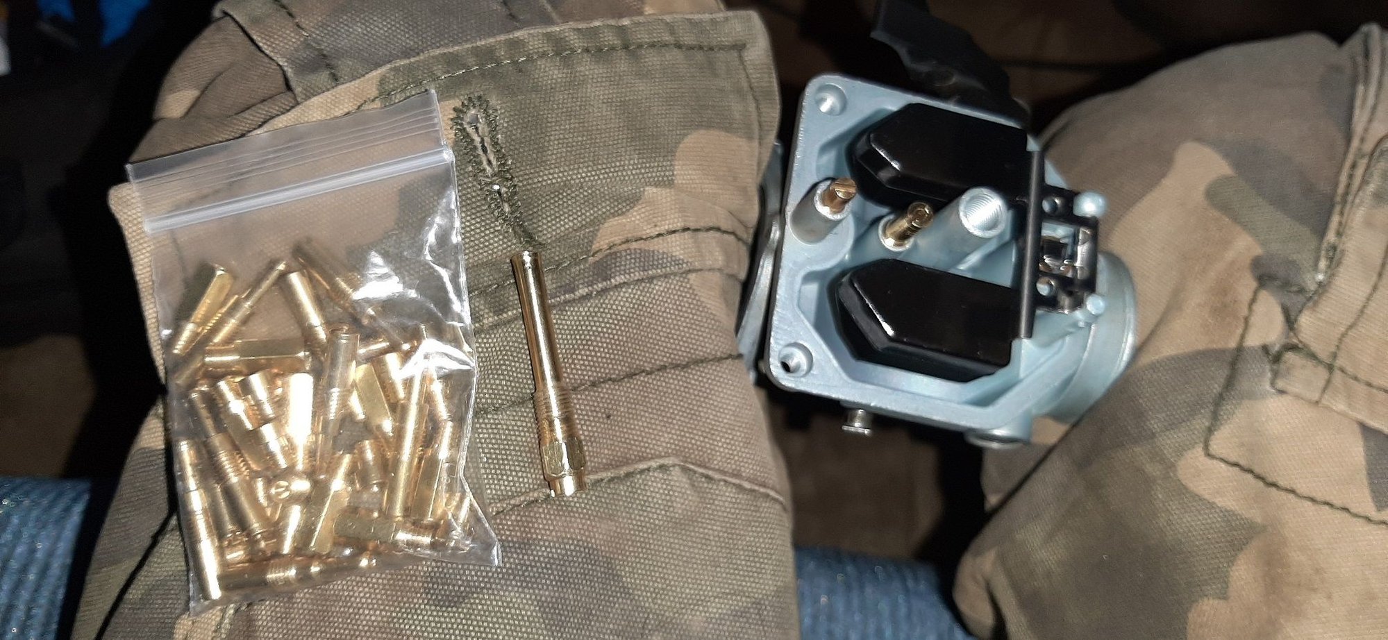

i picked up this carb from amazon
https://www.amazon.com/gp/product/B0...k_ql_qh_dp_hza https://www.amazon.com/gp/product/B0...k_ql_qh_dp_hza
. the main jet in it is bigger than the pilot jet. i dont have anything close and didnt know main jets come this big. is it called something different and where can i find replacements? thanks
Old Sep 20, 2020 | 02:41 AM
Posts: 7,489
Likes: 387
You have also taken out the emulsion tube, the main jet is the little screwed in thing at the bottom of the emulsion tube.
