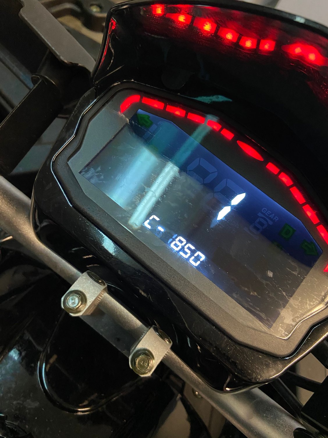

My second problem is the display, it shows an error code and it wont show anything else, C-1850 is the code, any idea?

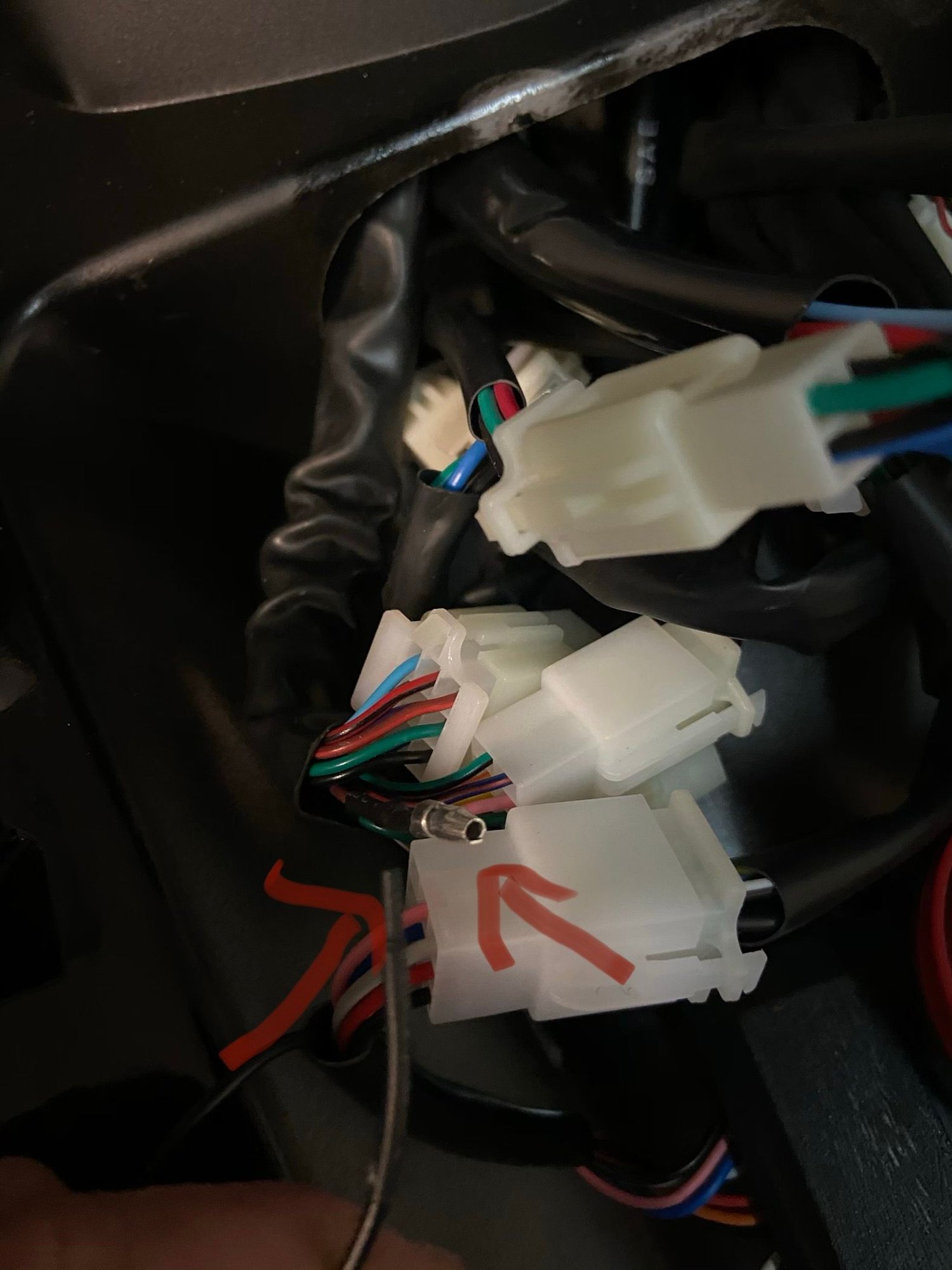

Also, i noticed two black cable not connected to anything in the electrical box, one looks like an antenna, wich make sense because i have a remote for it, but the other one with the crimp on?

Contact the dealer who sold it to you they should at least know what error codes mean. The idle problem could be a partly blocked idle jet or idle mix not set properly at the factory. Change the plug first, you never know. If that doesn't work, and cleaning the carb out doesn't fix the problem, altering the idle mixture a little at a time, may work.

Thanks will look into it for the idle. But for the code i contacted the company that sold it to me and they have no idea, they dont know the machines at all.. they even make me call their supplier who dosnt know either. I will have to call in china lol.
They at least sending me a new display.. i doubt its faulty but who knows..

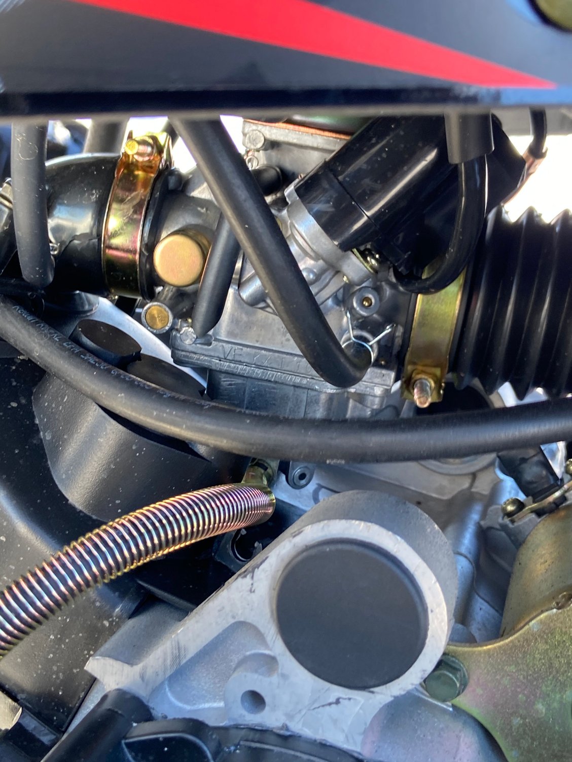

Any idea where is the mixture screw on these? Some sites say its pz27 other pz30, ive look all around and cant locate it.

Usually under the front of the carb, often blanked off. This is to stop you messing with it so don't unless you have already tried the other fixes first.

Is the mixture screw behind that big brass cap on the left or behind the smaller one just underneath? It idle good but stall at anytime, warm or not.

Usually it is actually under the carb, however, just checked the net and it looks like the small brass plug covers the screw https://www.pinterest.de/pin/327918416620460158/ the bigger cap covers the end of the throttle spindle.

thanks! This diagram is just what i wanted.

Any luck with the c-1850 message? I just got my son a raptor 200 and it’s doing the same thing. Also we have to give it a lot of gas to get moving, is this normal?
