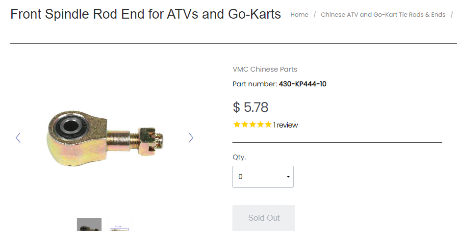

I've been looking for this part without any luck. I found them on VMC but they do not have any stock and Gateway ATV seems to be out of business.
Any recommendations on places to look for these or similar parts? Thanks for the help.

If it is just the rubber bush that has failed, you will be able to get a new one from an engineers suppliers. You need to know inside dia of bush, outside dia and length, then press old bush out in a vice between two sockets, and press the new one in. Probably cost a lot more than $5.78 for the bush but better quality rubber.
