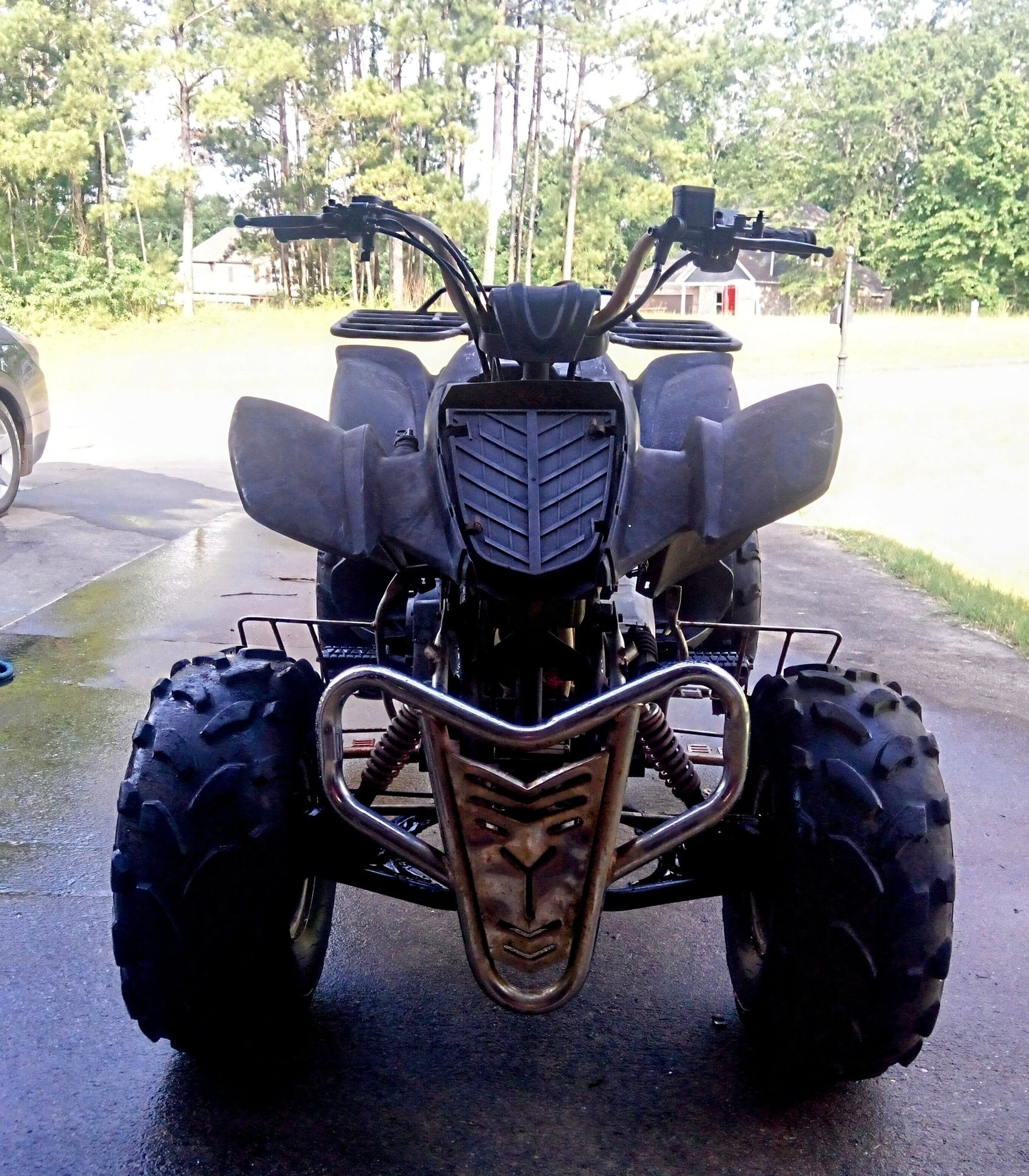

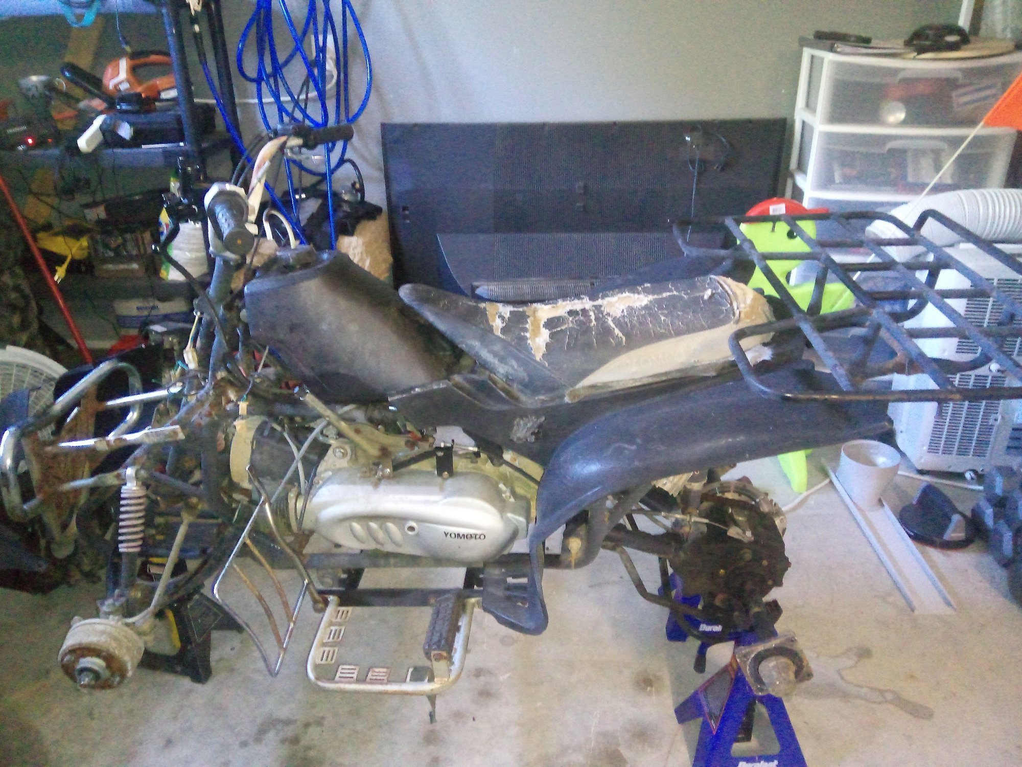

Also, here are a few pics of my quad
Old Jun 25, 2022 | 01:57 AM
Posts: 7,487
Likes: 387
Hard to tell from the pics but it looks like a GY6 engine with shaft drive, unusual. I rather think Yamoto specialised in shaft drive so could well be a name altered to avoid litigation.I would get the seat re-upholstered, we get seats re-covered locally even though Honda/Yamaha/Suzuki seats are easy to get, re-upholstery is cheaper, in Suzuki's case much cheaper. Shocks on Chinese stuff tend to be over stiff anyway so checking lengths on fully extended, fully compressed and the mounting point shapes/sizes is about all you can do, then go for the closest match. Brake handles are fairly generic. I got the wrong lever for an Apache recently and it is an exact match for some Hondas.

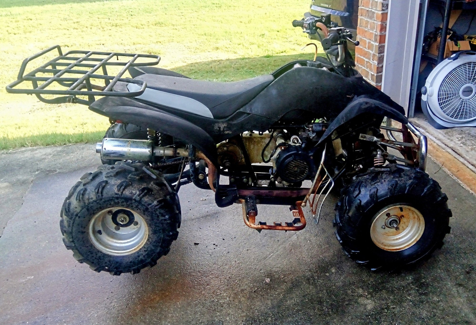

Default Clearer pics of my quad
Old Jun 26, 2022 | 08:45 AM
Travis3's Avatar
Joined: Jun 2022
Posts: 12
From: Alabama
I finally got it cranked after finding a Direct current CDI box on Amazon. Also found a seat on Amazon for $29 dollars. It won't stay idled, as soon as I let off the throttle, it dies. also replaced the brake reservoir and bled the rear brakes but the rear brakes still will not work. And I can't get the quad in neutral or reverse.

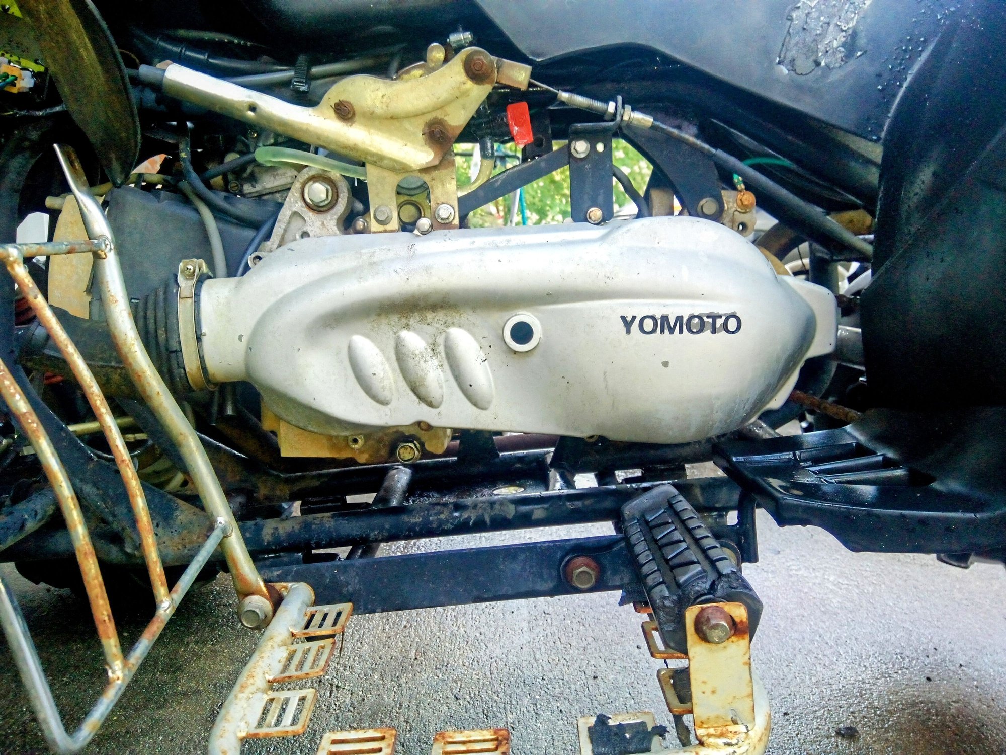

Default Shifter
I think my shifter isn't staying in neutral because the teeth are worn down pretty bad. Anyone know what I need to look for in ordering a new one ?
Old Jun 27, 2022 | 01:30 AM
Posts: 7,487
Likes: 387
Ah, so it isn't shaft drive, my mistake. That bevel box forward neutral reverse was used by a few makers, so possible other assemblies would fit. Is it the lever which jumps out, or the actual gearbox which has worn dogs? The cable adjuster is loose, which won't help, and the gearbox filler cap should have a breather pipe, so it may be full of water. Brakes on quads can be bad to bleed, I suspect they used the reverse bleeding technique at the factory, pumping fluid in through bleed nipple until fluid reservoir was full. I sometimes take calipers off mountings and lay them so there is an all upwards run of the pipe, so no pockets where air can be trapped, when bleeding.
