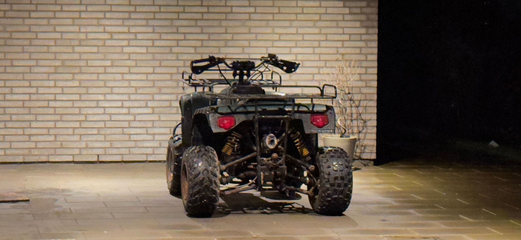

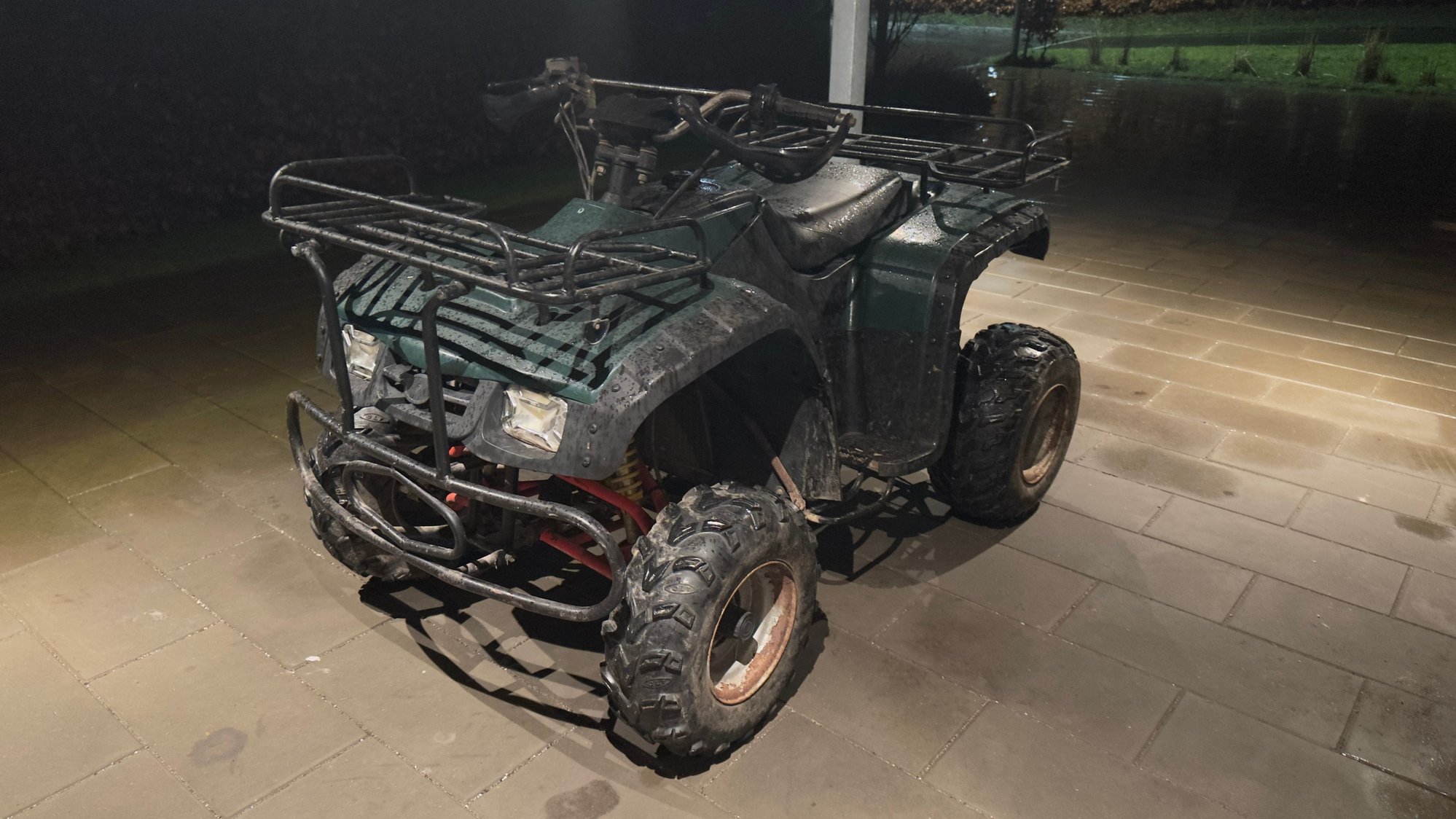

Hey!

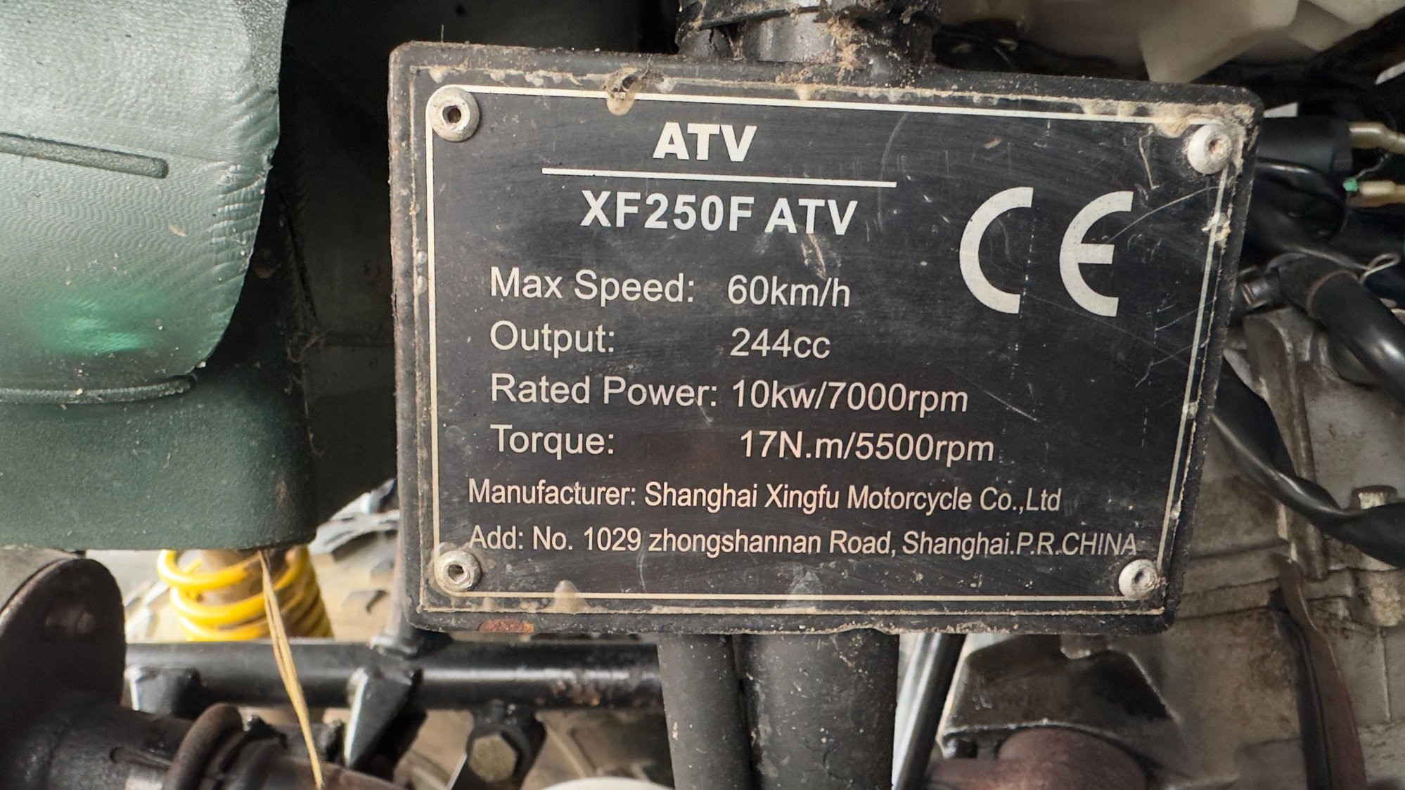

I have an XF250F atv a pretty large one for a 250cc. It's currently having some issues getting up to speed and all in all, just using the drive gear.
The last time I used it It ran fine for like 5 minutes, then after an acceleration it started popping and backfiring. And couldn't get up to speed again.
Yesterday I tried lifting the rear tires off the ground (it's rear wheel driven). Then giving it gas, and for the first few seconds, the wheels rotate fine, but after a few seconds it starts to drift between which wheel drives and which is not rotating. It's for the most part the right rotating the most.
I have just switched out the carburettor and the airfilter along with the sparkplug, to make sure it wasn't a fuel related issue.
It revs fine in neutral all the way up, and it drives like it should in reverse, drives even faster than the forward gear atm.
I have tried adjusting the gearselector, but with no luck. Atm it doesn't really go into forward unless you do it with your hand on the gearbox.
I hope someone can help, it has been pretty frustrating.
Thank you in advance
