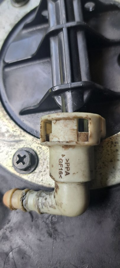

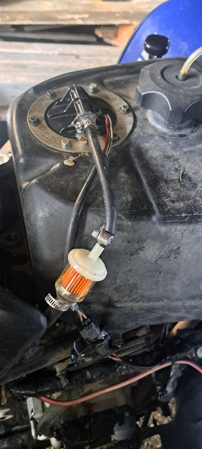

Bonjour Connaissez ous un modèle de.pompe.a essence de remplacement univversel qui pourrait fiter dans.le réservoir
Quad chinois Kazuma jacquar 500 4x4 2007

I would be surprised if you can't get genuine replacements as I'm fairly sure Kazuma are still trading. On line sellers list the Jaguar as having a vacuum operated pump, so a suction pump near the carburettor. If your machine is fuel injection it will have a high pressure (50psi) electric pump in the tank. These tend to come in stock sizes, so go to a local motorcycle repair shop with the pump, they may have a similar pump.

Kazuma provided references here and there they do not recognize the system in France the system is B.O discontinued according to a picture of the tank everything works but.the.psi disconnects the attempts that I made at the repair. The hoses from 1/4 to 3/8 do not hold The blow of the pump

If the pump outlet is broken you need to find a replacement. The pump will be a standard part as will the housing. Motorcycles will use it, so motorcycle repairers are likely to know what else does. If it is just the pipe won't stay on the fittings, I'm sure specialist motorsport suppliers will be able to make up a new pipe.
