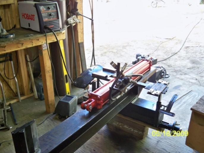

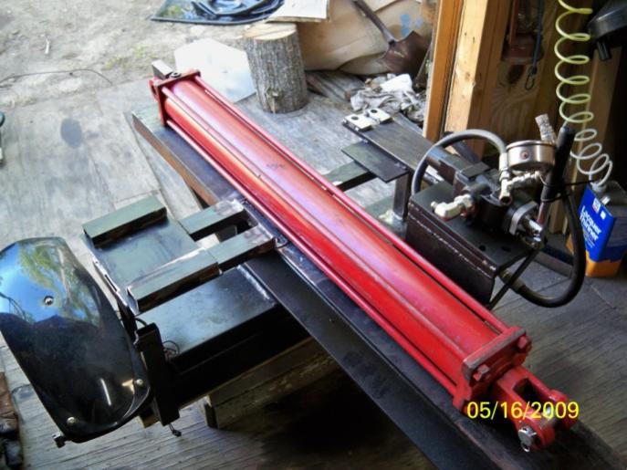

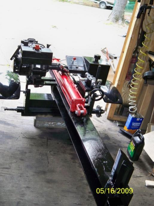

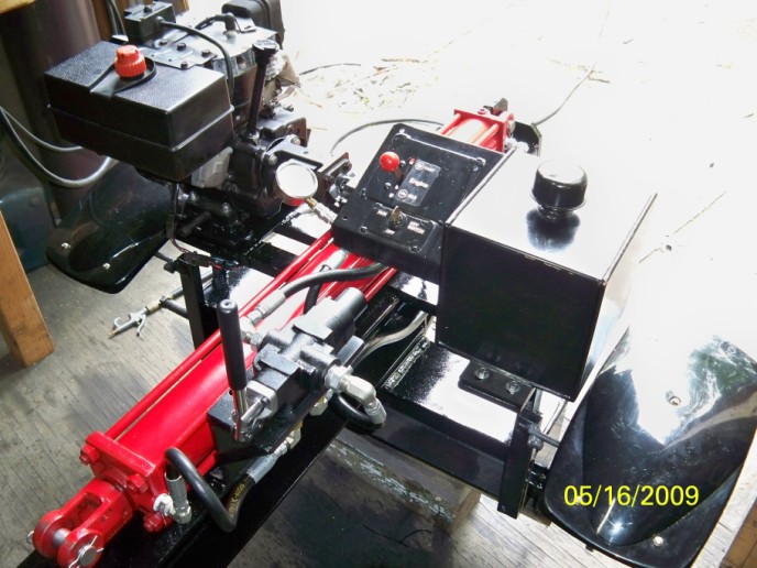

The 40" cylinder (2.75" x 40" rod 3000psi) I picked up new at a swap meet for $75! Spool valve is a Speeco with detent-
The 8 hp motor (electric start) came off an old snow blower my neighbor was throwing away- the engine was in excellent shape. You can see the control panel I made for it with the blower levers- welded to the tank.
The beam came from a scrap yard for $20-
I bought the pump (haldex 13.6 gpm 3000 psi 2-stage) & fluid tank from NT- and the 7" wedge came from ebay.
It's all glued together by my humble but mighty little Hobart 210 Mig (which I love)
It'll take a 20" log (stove only takes an 18" log) I figure it's around 20-24 ton
I have maybe $300 into this splitter and a weeks worth of building-
oh- the tires & fenders came off an old yerf dog go kart- the axle I shortened from a boat trailer...
Haven't been able to stall it yet- splits cherry & cedar like butter and pops oak like it's pine. Pretty fast cycle also.
Attached Thumbnails my home made wood splitter- what'cha think?-wood-splitter.jpg   my home made wood splitter- what'cha think?-wood-splitter-2-.jpg   my home made wood splitter- what'cha think?-wood-splitter-3-.jpg   my home made wood splitter- what'cha think?-wood-splitter-4-.jpg   my home made wood splitter- what'cha think?-wood-splitter-5-.jpg

more pics
Attached Thumbnails my home made wood splitter- what'cha think?-wood-splitter-6-.jpg   my home made wood splitter- what'cha think?-wood-splitter-7-.jpg   my home made wood splitter- what'cha think?-wood-splitter-8-.jpg   my home made wood splitter- what'cha think?-wood-splitter-9-.jpg   my home made wood splitter- what'cha think?-wood-splitter-11-.jpg

and 2 more-
Attached Thumbnails my home made wood splitter- what'cha think?-wood-splitter-10-.jpg   my home made wood splitter- what'cha think?-wood-splitter-12-.jpg
