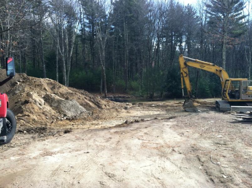

we're in the middle of building a 26'x26' two car garage- with a great room (20' ceilings) & balcony above the garage. starting to frame tomorrow...
you don't need a loaded hindge on the garage door to the house, but it does need to be steel, and you do need to use fire rated sheetrock on the garage ceiling (like moose said), totally sealed off, before the inspector will sign off the permit.
the entire job from footings to finish should come in around $55k
$29k of which is just foundation cement & site work!
go with the 10' ceilings if you can afford the lumber- won't be cheap- walls will need to be 2x6 minimum.
without a doubt- put in an exterior door- makes garage access a lot easier if you lose power or just want quick entry without having to deal with the big garage door.

BG No quad tracks going up the piles of dirt?

that's a very steep hill- but yes, I was playing on it for a while
all that dirt is staying
