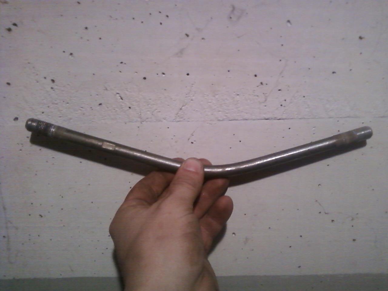

Old Jul 14, 2015 | 07:29 PM
  #40
jgar's Avatar
Joined: Jun 2010
Posts: 2,971
From: Gardner ma.
Aligning the front is rather easy, occasionally it takes some time.
When you remove the tie rod end from the tie rod count the revolutions. This should get you in the ball park. The rest is trial and error with a tape measure and a box wrench.
With sport quads I will toe out the alignment 1/4" overall. It helps with handling at higher speeds.
This a tie rod came off of my old 400ex. That stump jumped in front of me!
Attached Thumbnails Will Sears auto or maaco do a front end alignment for me?-tr1.jpg
