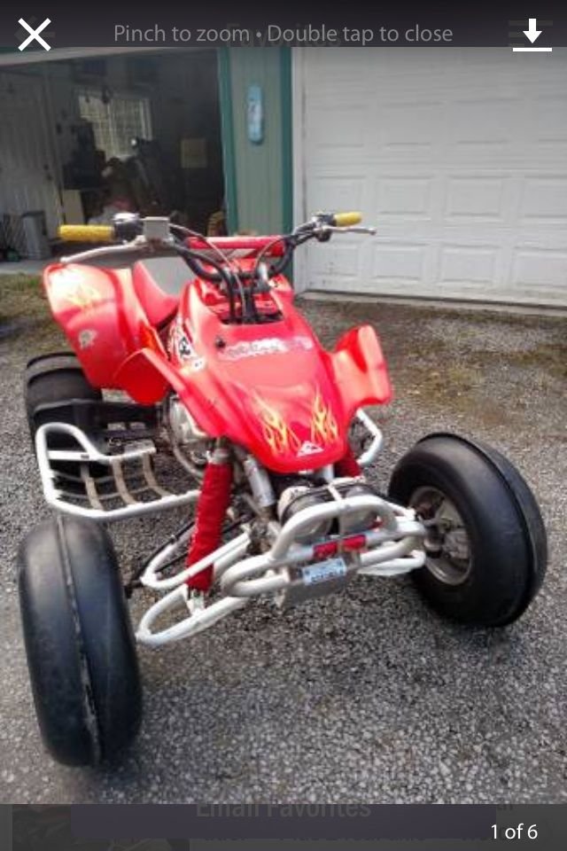

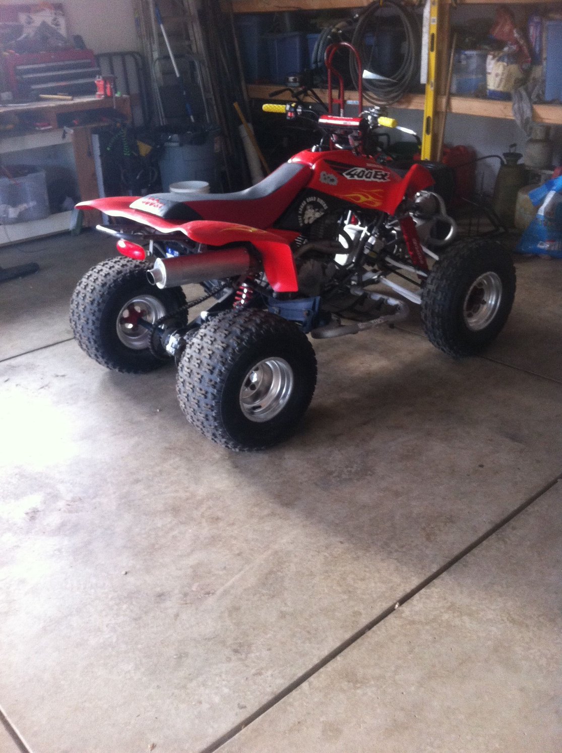

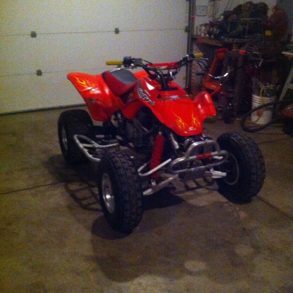

Hey so I am new to the website but I have a question I bought a 400ex it's a 1999 I was told and it has a 440kit eldebrock carb big gun exhaust kn air filter and I believe that is all that is done to the engine the lady I bought it from said that she bought it from a guy that did all the work and the bike has lots more bolt on extras also but the way the carb is set up it doesn't have a choke an wont idle is there anything I can do to make it idle and possibly give it a choke it will idle for a second or two then shut off and it really annoying plus it can be hard to start also so any tips or tricks to know with all the work it has done to it I should know
