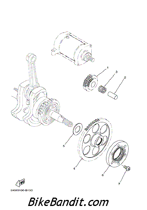

Regulator wouldn't have caused the noise. Again I'd pull the cover and check the stator and flywheel area out. Could be in the starter clutch area on the flywheel making noise.
