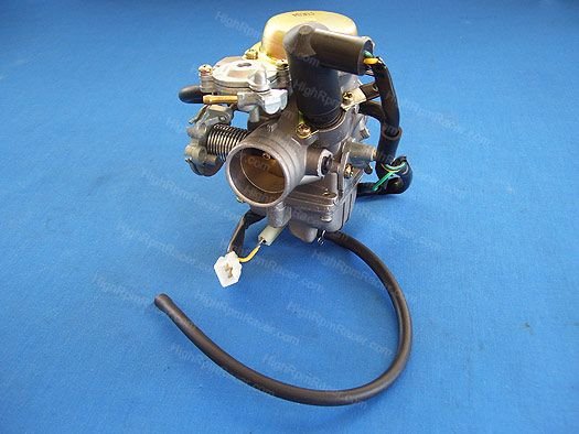

ok this is a "picture" of my carb, yea this is new and a 'stock' photo, but I'm sure this is it.
the black "cylinder" that the yellow and blue wires go into in this picture. on my carb that black cylinder gets very warm to the touch. Is that suppose to happen? this is when I am trying to start it, It hasn't even ran and this is very warm to the touch.
What part is it? what is it called? does it come apart? Is it suppose to twist?
I cannot get the camera into the area to take a picture of mine, it's too crowded.
