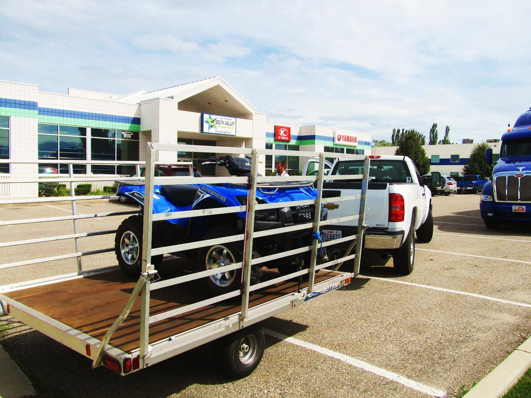

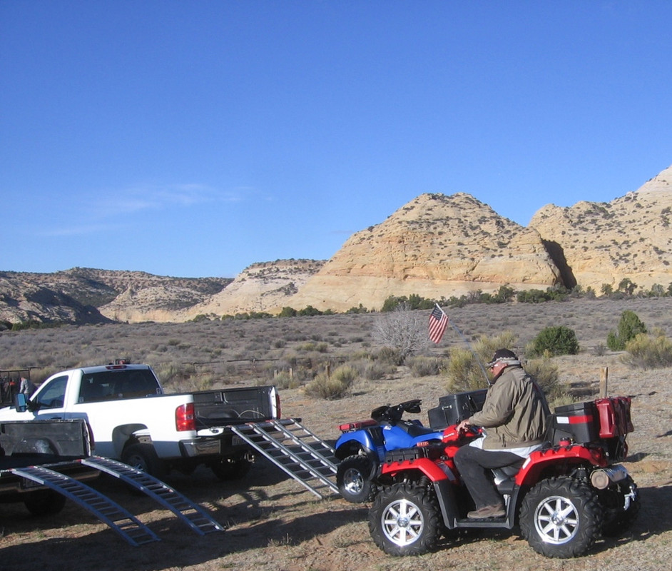

I have 6' ramps and have used them for about 17-18 years now. Mine are the straight ones behind the white pickup. I like the one my friend uses too.
I hook the chains that keep it from slipping off the tailgate to the cables that hold the tailgate up and strap it down to the cargo hooks that are in the bottom corners of the bed.
I have a nice aluminum trailer that I use when I have my camper in the truck too. I just find carrying it in the bed of my truck easier than using the trailer.
I would never consider using anything that can slip off the tailgate. That's just an accident waiting to happen.
