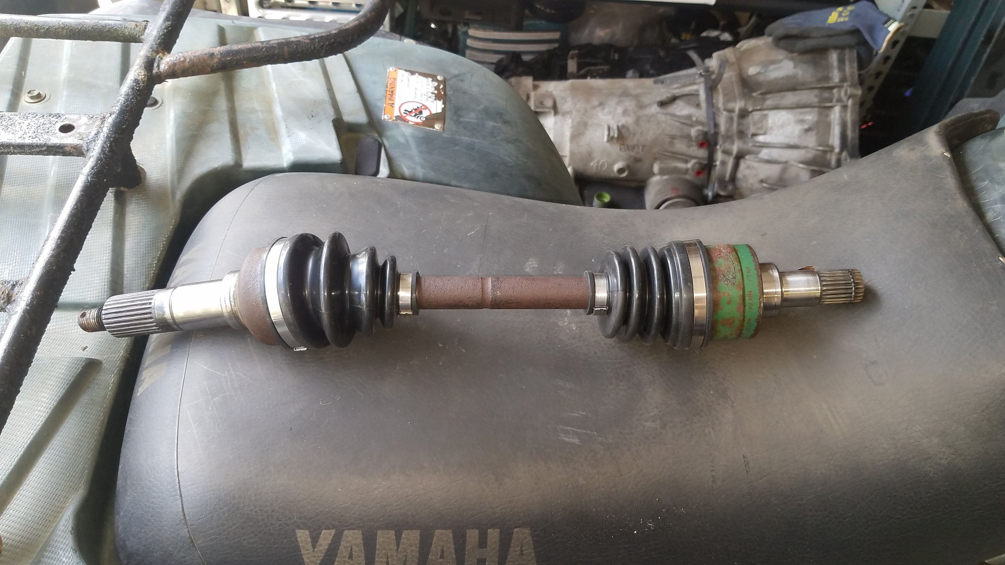

What type CV Boot bands is everyone using? I have used different ones but I'm seeing some different band types and tools to install them since I last had to replace one. Thanks!

When I did the front axles on my Timberwolf recently I used All ***** brand boot kits, they came with the bands that you just pull tight, bend the tab over, and then bend the locking tabs on the sides down over to hold it in place. No special tools needed, just a pair of needle nose pliers for pulling tight and a small hammer to bend down and flatten the tabs to lock it in place. Worked great and still holding strong.

I have both tools the one for the clamp above and one for the ratcheting style clamps. I prefer the second style of clamp as it is easier to work in tight spaces but you have to know the size you want so i usually just order a bag of the other style. The tool makes it easier to get them tight especially if the boot is still on the machine..
