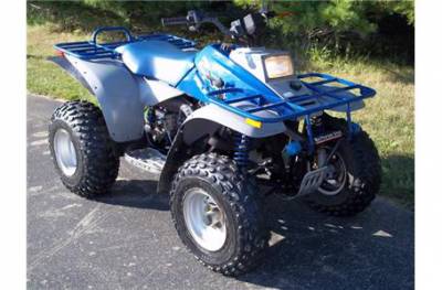

Looks like an old 92-94 Polaris Trail Boss 250... or what's left of one. Look on the right side frame down tube for any vin# info.
