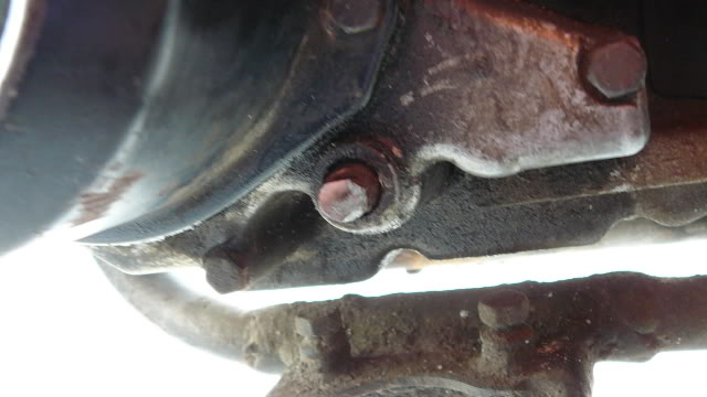

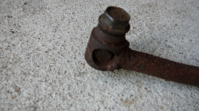

Hello this is my first post and my first big problem. I realy like this forum it reminds me alot like pwctoday but for atvs. Ok my problem. My friend was riding my 3 wheeler on the beach and the shifter got caught on a log and snapped off. I am looking for advice on the best route to go and how I should take it apart to fix it. I am not sure where to take it apart to get the rod out to weld and or get a new one. Here are some pics of my problem.

Please give me the best advise so I can get this thing running this weekend

Rebar for a foot peg...that's a new one!
It does look bent so that may be a problem, but my first thought was to just weld an extension on it so you don't have to tear into the trans.

I would guess what's left may have gotten bent enough to bind if the thing got torqued around enough to snap it off...
Does it turn freely with a vice grip?
Anyhow, even if it does, I think my preference would be to tear it down and replace the shift shaft. Welding it back on would be tempting, but I'd be afraid of melting the shaft seal.

A quick fix would be to drill into the shaft and thread it, then drill into the broken off end and tap it, install a stud and screw it together, check shifter position then tack weld where it was broke.
I have been tapping them to 6mm inside. Short bursts of weld then let cool has kept from burning the shift shaft seal.
